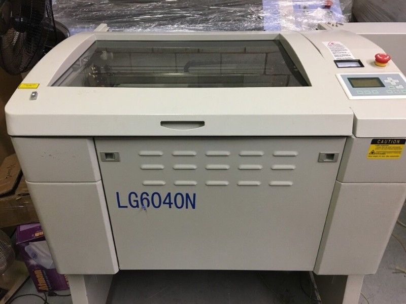

Newest member of my laser farm....80W 600X400
Newest member of my laser farm…80W 600X400

How much? What controller? NICE!
$800 USD with a Leetro controller. 2 months old.

Runs around 5-7K USD brand new. Could not pass it up. Has a tube extension housing on it already, thinking of putting a 120W tube in.

Brought it home today. Came with massive air assist pump, rotary (roller type) attachment and a big 6" exhaust fan. Was missing the software dongle for the Leetro controller so I pulled the Leetro and am 3/4 of the way done with installing a Ruida 6442 controller that I had laying around. Was advertised as a 600X400 mm work area, but actual usable is 600X530mm. Z bed moves about 400mm so lots of room for large round things :slight_smile:
Controller swap is complete, final size of the usable area is 625mm X 450mm with 50mm of Z bed travel. Set up the controller to turn the exhaust and air assist on and off automatically. Checked the power output with my laser power meter and it puts out 83W at 95% power (20mA, tube is rated for 25mA max) And it plays so nicely with LightBurn. I now need to sell my K40 to make some room, I’ll keep my 50W Redsail for engraving, and use my 60W and 80W for cutting.
