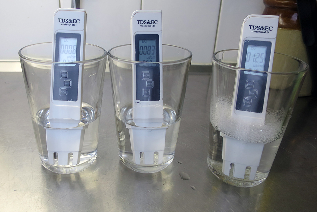

Add something that breaks the surface tension, with that the bubbles cannot form.
I use water wetter myself.
Here´s a pic with conductivity meters, left is plain distilled, middle is distilled with water wetter, right is distilled + dish soap. The middle is a bit high too, think i added too much water wetter to the glass :slight_smile:
