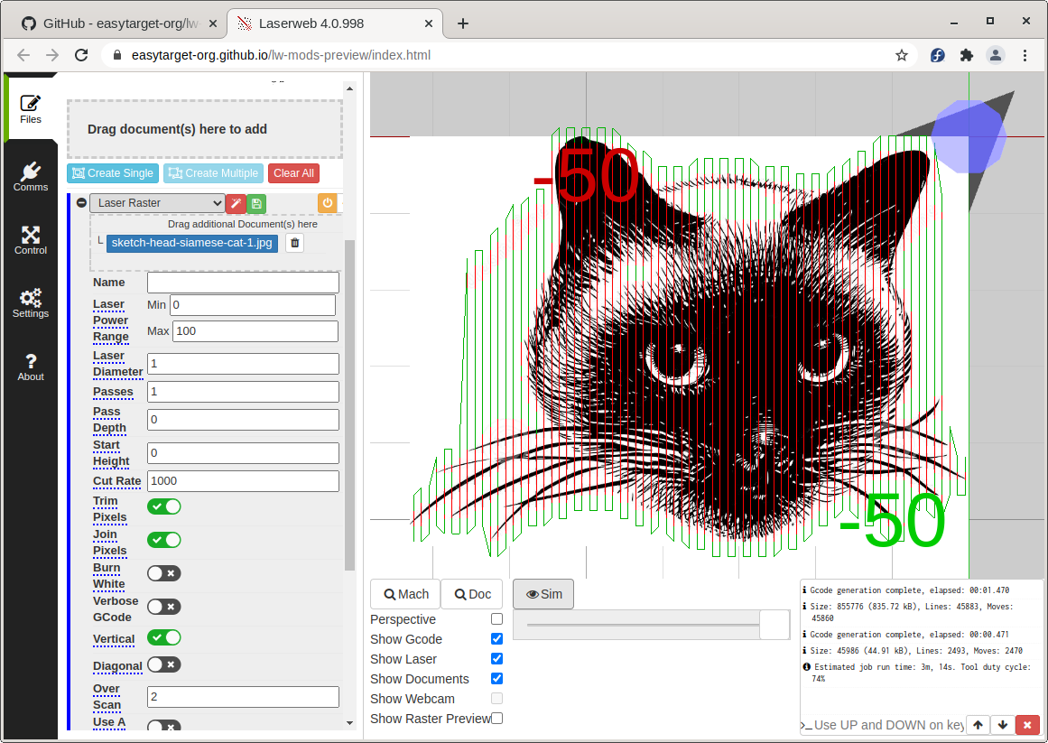

End result: Vertical rastering (and reverse diagonal too) is now an option.
Really handy if the material you are cutting tends to show raster lines (eg lots of laser markable plastics) since you can mitigate that a lot by making two passes at right-angles to each other. It might also suit some machine geometries better too.
