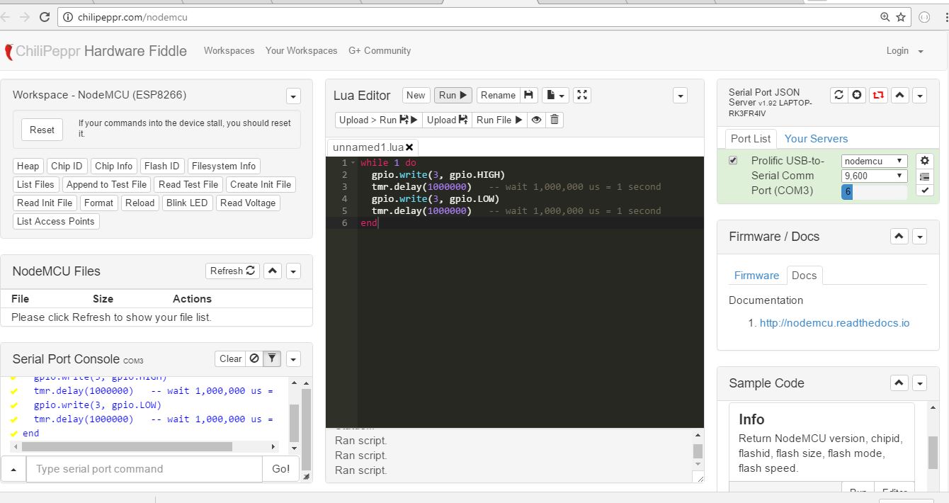

Node MCU workspace. I got the console cable and had no problem connecting and running basic blink but the same thing in John’s Chilipeppr nodemcu workspace I get nothing back and what looks like a stalled buffer trying to run the same program. I know this is new stuff so I’ve most likely missed something obvious. It was trivial to use the console cable and type the code. Much easier than arduino and pi stuff. These esp8266 guys a very cool.
Keep hitting Reset button until perhaps it starts to work. I find that I sometimes have to hit it 3 times with a delay each time of say a second. Or, reset your ESP8226. I tend to sometimes have to press the reset button on the NodeMCU’s to get it to go. Once connected though it works like a dream.
BTW, my recommendation is to never use tmr.delay() on an ESP8266. That just spins the processor and kills your ability to let it do other stuff like Wifi. You want, instead, to use tmr.alarm() with a callback. Wayyyyyyy better way to do it, but you have to change the way you think. Don’t fall into Arduino-like approaches.
