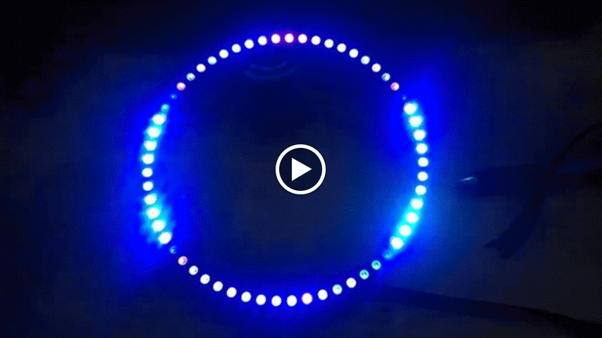

NoisePlayground on Adafruit's NEOPIXEL Ring.
NoisePlayground on Adafruit’s NEOPIXEL Ring.
I hesitate to put this under the “Show off your work” category, this is more like “Show off Garcia and Kreigsman work” :wink:
Hrm, I’m starting to wonder what it would do on a single strip of 48 pixels. :slight_smile:
@Jon_Burroughs : show it all off! Dan and I really love to see what people do with it all.
@Ashley_M_Kirchner_No : you should try it. Either 2D noise (one spatial axis, plus time), or 3D matrix noise (X, Y, time) but rendered onto the strip ‘flat’. Tell it you have an 8x6 matrix with serpentine layout…
