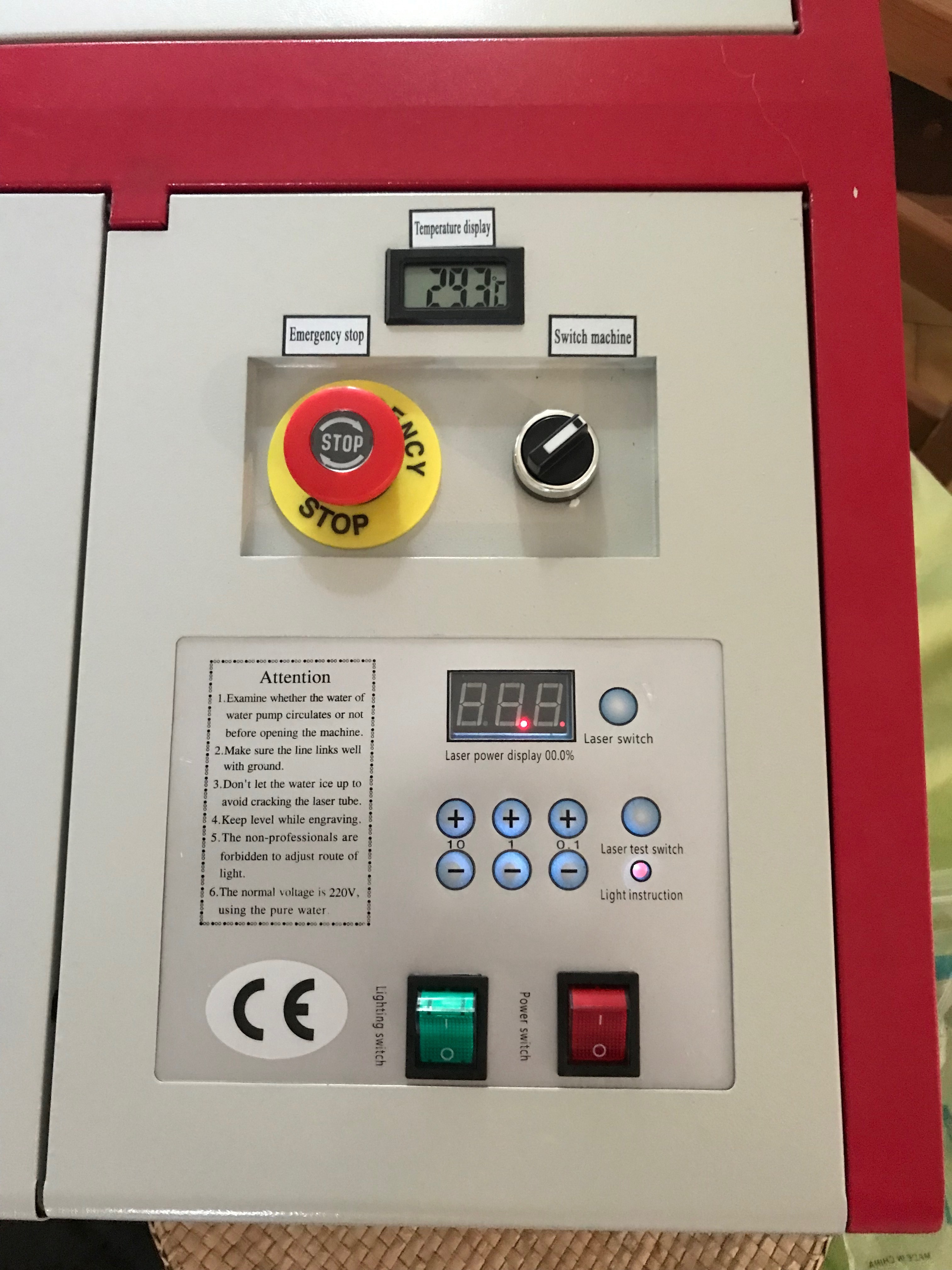

I’ll try this week_end lower speed. Could you give me a percentage idea for that ?
I don’t have other power gauge than percentage, as you see on the picture :frowning:
Thanks anyway for your help
I’m guessing you do not have an air assist? An air assist will keep the wood from flaming up.
For cutting the focus point should be halfway into the piece being cut which gives you the best cut profile.
For most tubes the max operating power is about 18mA. Typically you operate at a max of about 15mA for best tube life. The problem with the percentage power settings is that they can be variable for percentage relative to current. For my machine, before I converted to a permanent amp meter and variable resistor, 70% gave me about 18mA. At 10mm/s a typical power might be around 9mA which for me would have called for 30-35% power. A good mod to make to your machine would be to convert to analog power vs the digital controller. Knowing amps is better than simply have a digital controller.

also BEWARE!!! The digital power panels are notoriously known for over-driving the tubes, and no two seem to be the same scale. Your best method would be to install a mA meter between the tube return line and the laser PSU(NOT the red wire! the one nearest the first mirror is the one you want).
