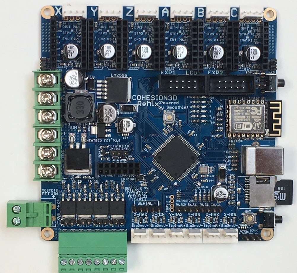

I have a cohesion Remix board I got from @raykholo years ago lying around waiting for something to do - should I go for it and rewire the whole thing or leave this for another day?

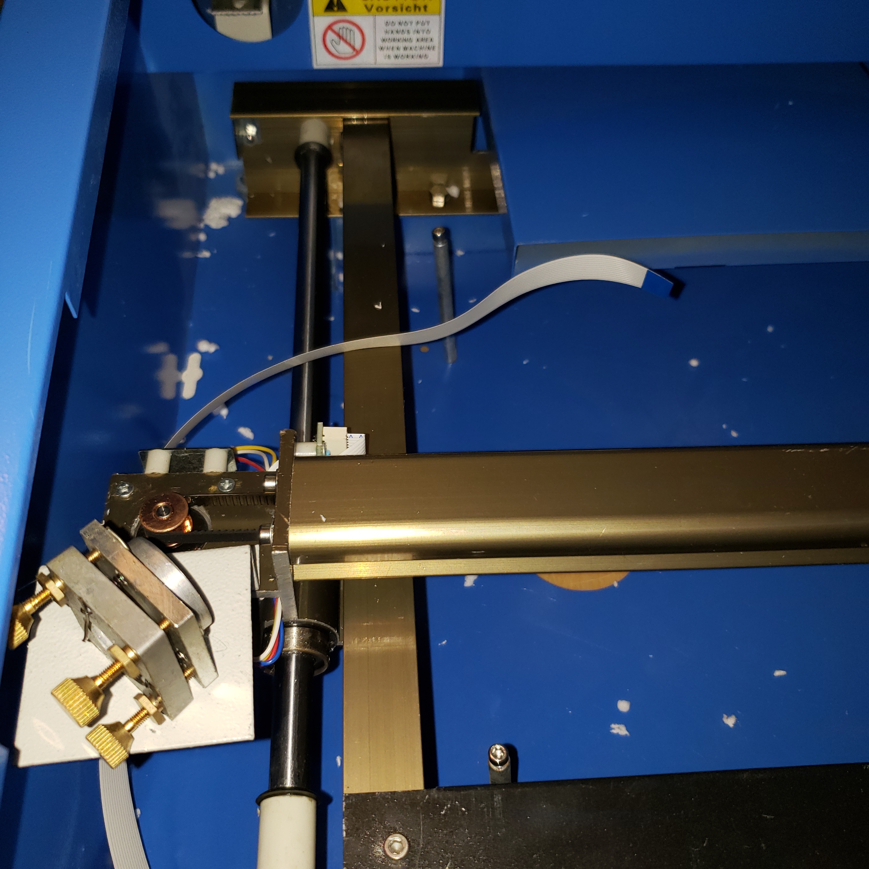

That is part of the plan. I have a 24v psu to wire in. Just got it today. Trying to get the machine up and running tonight. Did a visual inspection and found a few things. Thermocouple wire was crimped between the laser lid and screw tab, flattening the wire. RIbbon cable cable to the gantry is disconnected and flopping around in the cabinet. Need to get it plugged back in to get the machine moving. Tiny things, but leads me to the conclusion that i need to double check everything before turning it on.

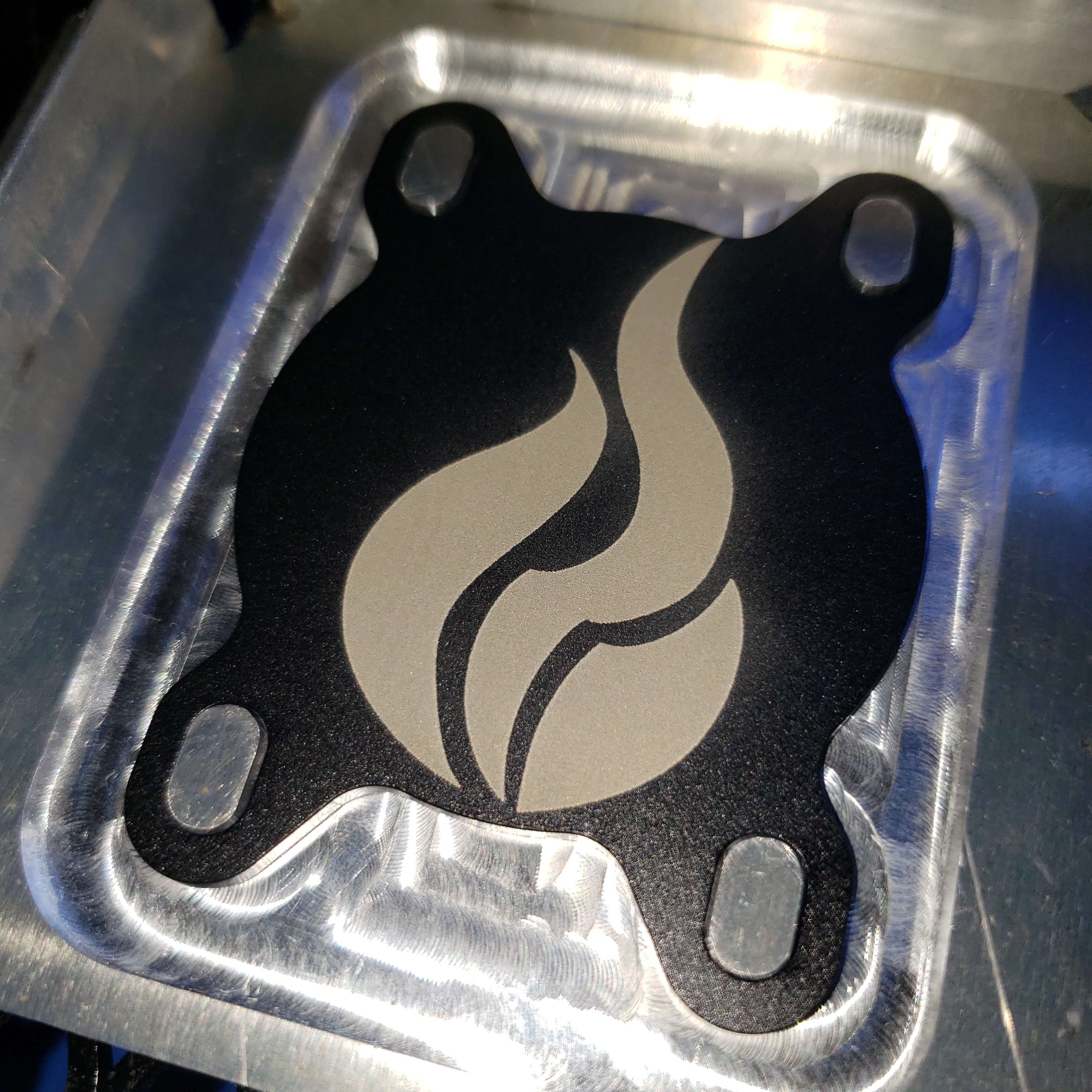

Ok! Made some progress!
Removed the xy gantry and removed the exhaust slot. Replaced the gantry and aligned the mirrors.
Upgraded the water cooling by pulling a gallon of distilled water out of the bucket and replaced it with a frozen gallon of distilled water. Tube is running at 18C, way better than the 24C it was at.
Made a tilt test cut to find my focus point. 68.9 mm from the head stage.
Pulled out the stock bed and made a new bed from 13 gauge expanded metal. Painted it black. Screwed it down with some fender washers.
Measured off the head stage to the expanded metal. 6mm below the focus plane.
Engraved a 200x200 box into the painted expanded metal for guides.

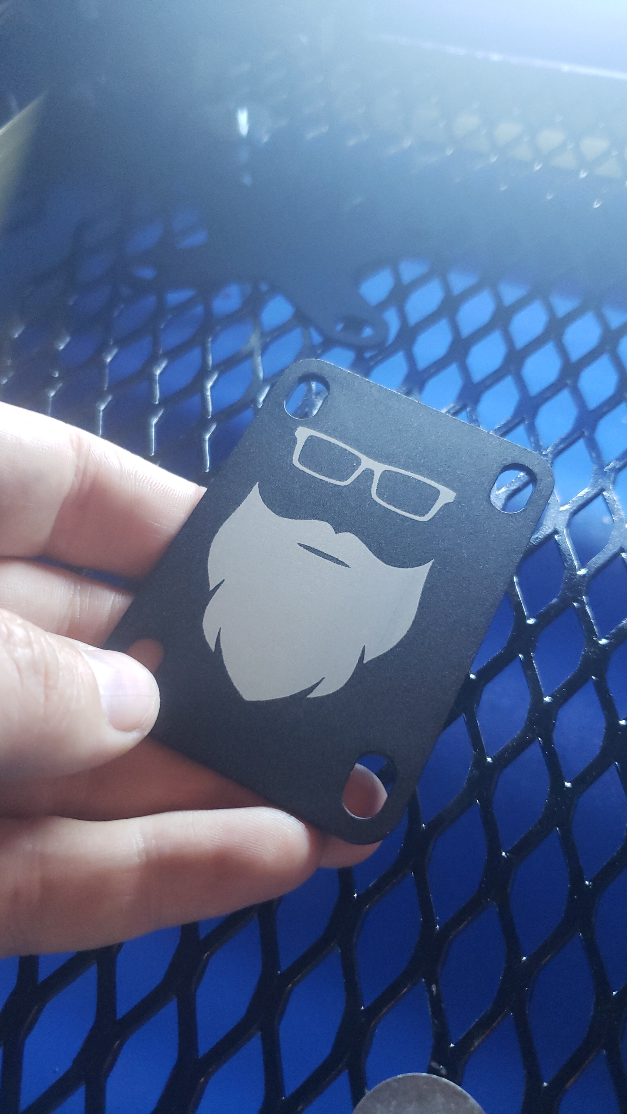

Shimmed a part to see how it would engrave.
I’m pretty happy with that! I need to get some aluminum angle to make fences.
Also, any tips on making it come out whiter? It’s kinda grey. I’m running at 35%, 200mm/s
Any help would be appreciated!

Not sure about the greyness. Haven’t messed much with anodized Al. You can try going up on the power.
