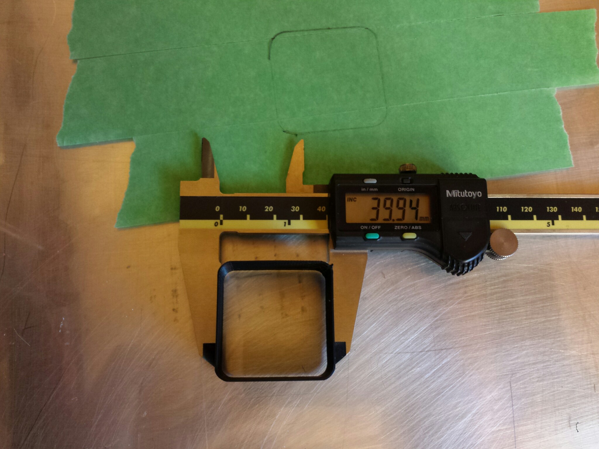

@Shauki is that a consistent .2 bigger, or does that scale with size?
I keep meaning to ask…are you heating the bed when printing ABS? @Shauki
I was able to print abs on superglue on blue tape, but the fumes were NASTY, and it went through a lot of glue.
