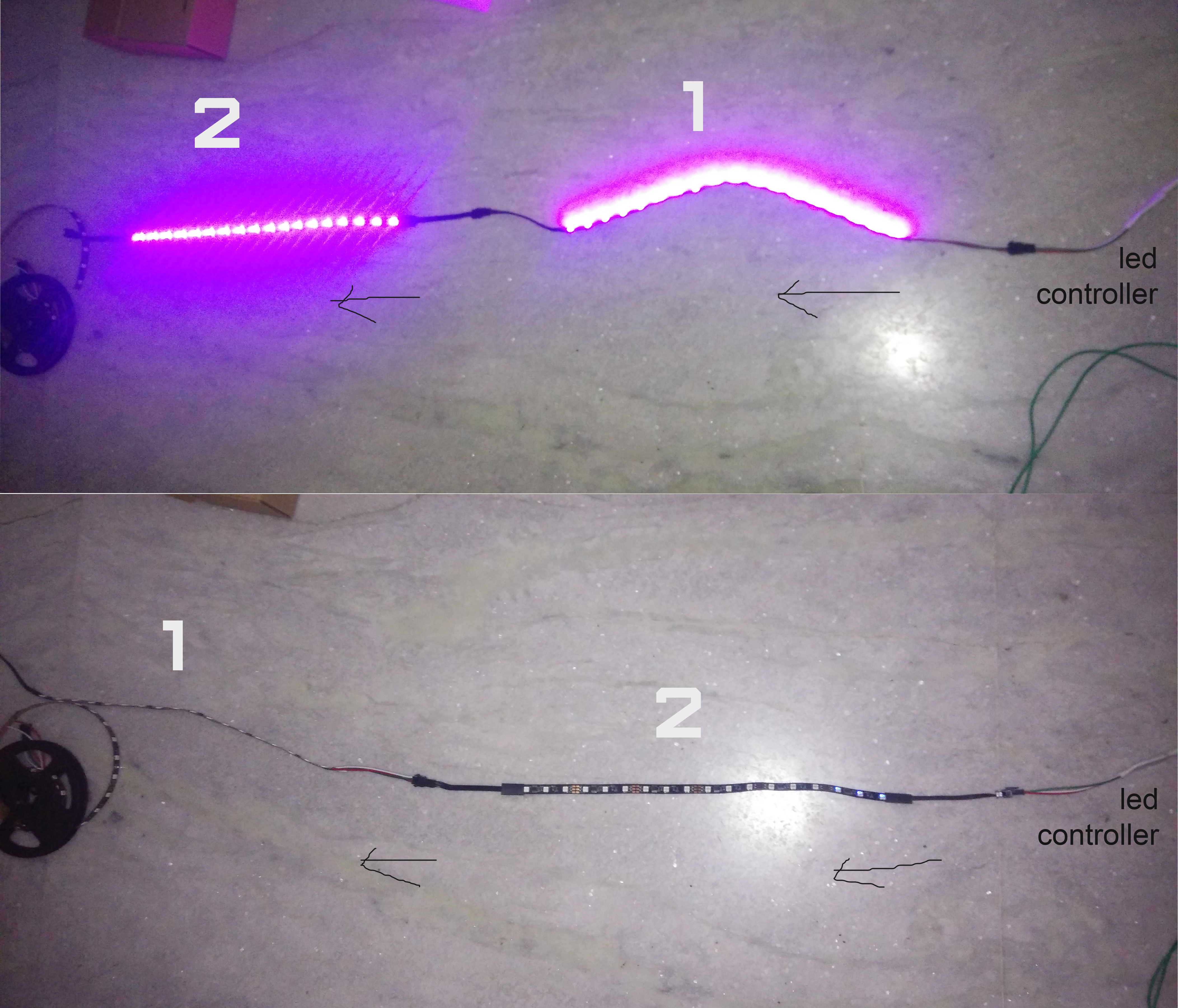

i have bought 5m ws2811 led strip from aliexpress,from that i have 40cmx2 strip.i was testing with the ws2811led controller which has preset effect built in. Kindly check the pic bellow, the problem is when i am connecting led strip as it was out of box(i mean 1>2>rest 5m roll) is working but when i am connecting 2>1>rest its not working.Curious to know what is the problem.

Wait Let me show you some more pics
@Mr_Happy yes I have done that problem is if I don’t connect (1) strip the rest not working.
@arpan_choudhury That doesn’t indicate whether or not you did any further testing. I’d also disconnect the rest of the roll as part of that testing. i.e Try 1>2 and then 2>1. Again, repeat it several times.
Just confirming -. You bought a 5m strip and cut a couple of 40cm strips from that and made your own connectors/cables for them. Strip 1 is identical to strip 2 and the wiring is consistent throughout.
@Andrew_Tuline yes that i was trying 1>2 is working fine but 2>1 not working.
http://imgur.com/HAmdWHm - check this pic @Scottie_D369
wiring and direction is correct…i have checked twice. Wierd problem :frowning:
And you did that several times for each configuration? (Your response would be. . I tested each configuration several times). If so, I’d remove all the connections and start again. At worst case, I’d solder them directly just for test purposes.

On strip 1 you may find a small surface mount resistor before the first LED. Look closely at the first LED and see if there is a small component on each side of the LED rather than just 1 on the rest of the LED’s.
