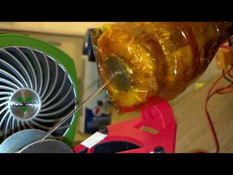

Not a printer, but John Ecker  has been working on this Filastruder for a
Not a printer, but @John_Ecker_GeoDroidJ has been working on this Filastruder for a while and has it running. I assume he’s been recycling failed prints, but I can’t be sure!
Originally shared by John Ecker (GeoDroidJohn)
#filastruder up and running. Collecting and spooling is a real problem that I have yet to solve. I am using PLA and it is very soft as it exits the nozzle. Lots of cooling is required to keep a consistent diameter.
They do not (yet) produce usable filament.
