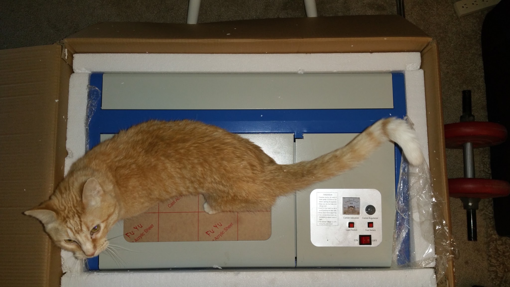

Not FastLED related, at least not directly, but this arrived today … and was promptly inspected by the cat … #timetocutstuff

Yeah, I signed up for their announcement, but considering this one was less than $400 NEW compared to the price of the Glowforge, and since at the time I had no idea when the Glowforge was getting released, I decided to get this one instead … it’s one of the thousands you find listed on eBay. And immediately two days later I saw Glowforge released …

It’s it fun how nearly any box can become an instant cat trap. They work amazingly well in just minutes!
My buddy got the “$400 eBay laser cutter” as its known. It’s a 40w co2 laser. Needs a cooling bath. The software will take some messing with, but in the end, its a very functional tool.
