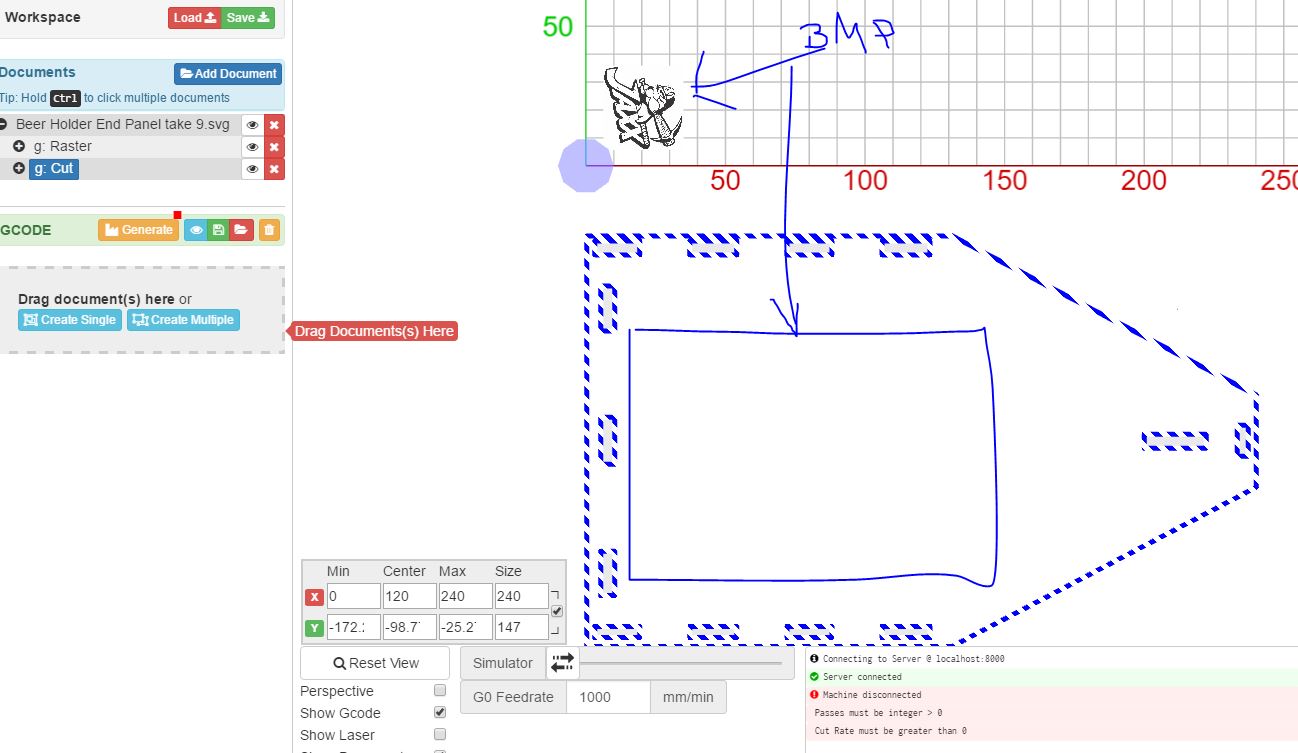

@Ariel_Yahni_UniKpty , your svg came in just fine. I was able to set the layers accordingly. However I took the svg file and exported it again out of curiosity and I think I’m missing something at that step. The bmp’s move and are out of scale. I created another document with one cut and one bmp file for testing. I can export to svg just fine. When I open it in lw4 I get the same results. The image is not to scale with the cut portion of the job. Where am I going wrong?
@Chuck_Comito maybe is the way Inkscape is saving the file. Send me the part and ill try to replicate in inkscape
Hi @Ariel_Yahni_UniKpty , here’s the link to the files. I put a screenshot of what it should look like and the files that make up the composition. I should mention though that I’ve tried this in Corel as well. That’s why I think I’m missing some sort of preparation when saving to svg. Like how the svg is handling the image that’s embedded. I hope it is a setting. If that’s all I should be rockin and rolling shortly.
@Chuck_Comito look at your file tree and you will see the difference. For some reason in your process its creating weird names on the files and multiples ones.
Also you need to prevent Clipping Mask and should always join path that are a single line

I opened your svg and it works great so a couple of questions. I noticed that the image looked different than the original so what did you do to it? Second, I opened the svg in corel (shits and giggles) and notice that the image was grouped but not with anything else. In other words, doesn’t it take more than one object to group them? Then I opened them in Inkscape and there aren’t any layers however I notice you have the object ID to Raster_1_ and label to #Raster_1_ while the cut object is ID Cut and Label#Cut. Can you explain what you did there or if it matters? I still think my issue is not understanding how to properly “embed” the image. thanks again!
@Chuck_Comito i cannot share all my secrets…
I did not change the image, i did ungroup and removed clipping mask. Yes it was grouped with some sort of invisible item. Then i went and cleaned the layers, joined path ( outside cut line ), etc.
