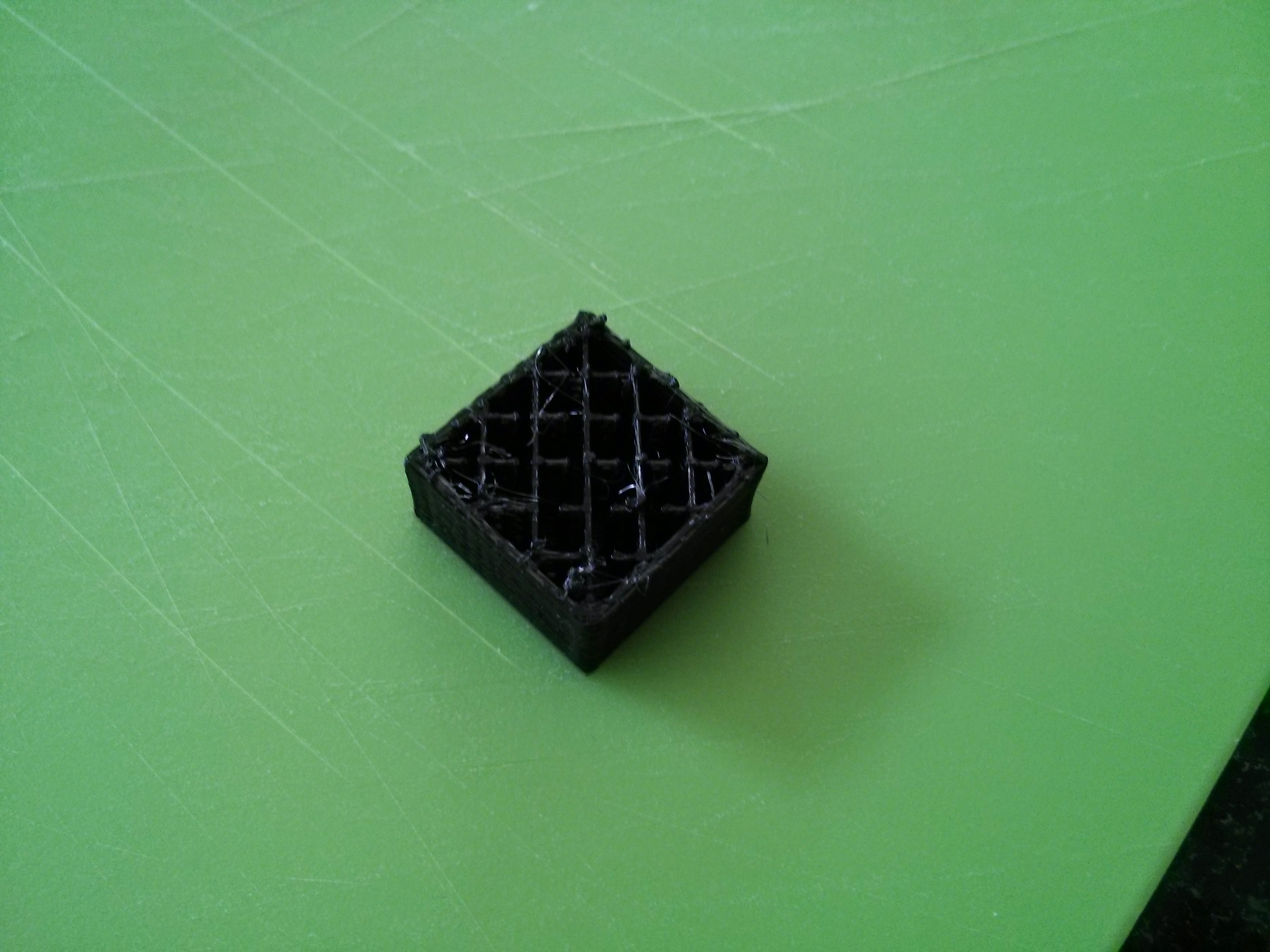

Not sure if you can see from the photo,
Not sure if you can see from the photo, but the infill doesn’t quite work. There are gaps down the sides of the fill squares.
What causes this? Too hot/cold/fast/slow?
Also could be nozzle size and layer height ratio. Or not enough extrusion.
I just started getting a similar defect (I’ll post some photos shortly). The crazy thing for me is that everything has been working fine for more than a month, and I’ve printed a ton of stuff and made no changes to my setup.
if so, it could be the filament - even if its the same brand, it could be a different batch.
does your slicer have a setting where it is not allowed to cross perimeters while extruding? While there are reasons for such a setting maybe during in-fill it is retracting the filament each time it nears the outer wall?
That could happen if there is moisture in the plastic
