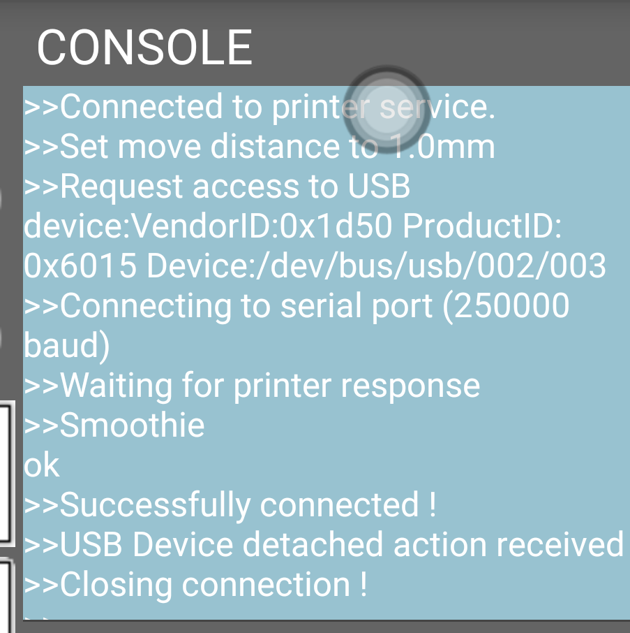

Not sure what is going on here. This is on a Note 5. I can connect, but then it disconnects immediately. Anything I’m missing?

this is often caused by a flaky USB-OTG adapter/Cable or not enough power. Since you already switched to a different power source, I would recommend to try another USB Cable+Adapter.
The App just gets informed by the Android OS that the USB connection is lost, it does not get any information about the reason.
@Mathias_Dietz you are most likely right about the flaky adapter. I will have to try another one. However, it is worth mentioning when the disconnect occurs the storage app launches at it seems to mount as a usb mass storage device just fine. It stays connected in this mode without issue. I’ve tried unmounting and reconnecting to no avail as well as playing around with usb debugging.
