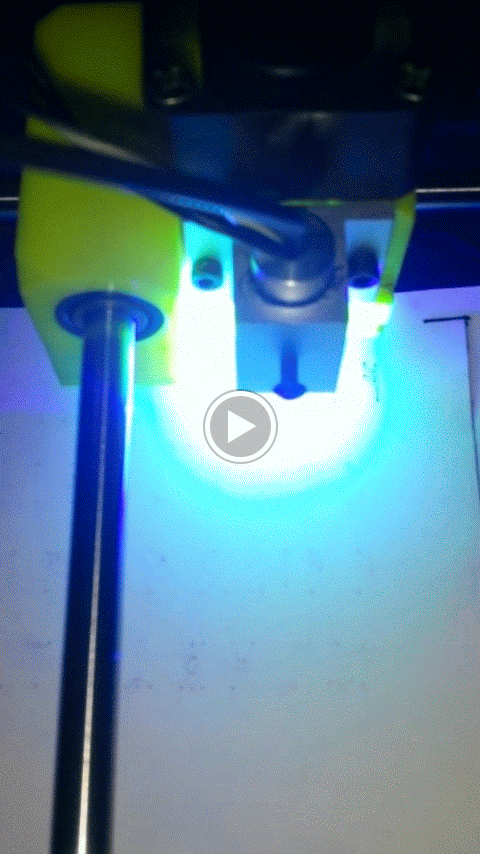

Not sure who else is toying with lasers and the TinyG, but here is a recent test using gcode originally generated with +Peter van der Walt 's LaserWeb. Sent to board via Coolterm.

The machine is in disarray right now, but it’s basically a Eustathios 3D printer without the extruder+hot end and no Z axis. Just the acrylic table. I’d like to eventually build it out as a complete 3D printer + laser with quick-change carriages and tinyg setting scripts, since the motion hardware is the same.
The laser is a 9mm 3W 445nm laser diode running at 1.5 amps (~2W out). It’s pressed into a 12mm module with a G-2 glass lense (lots of carefully applied thermal compound), and the 12mm module is secured in this aixiz heat sink you see in the video.
Driving the laser is a constant current/constant voltage buck converter pulling from the 24V PSU and set to deliver 8.2V out and…I guess 1.5A out. This is the ‘laser power’ unit. It doesn’t do PWM, though, so there’s another TTL driver (Advertised as CC on eBay, but I suspect it’s actually CV, based on the output readings) that sits between the laser power module and the diode itself. This TTL board is also connected to the tinyg PWM output.
For testing only, I have a power transistor between the laser power board and the TTL board, just to verify functionality and observe behaviors for spindle on/off, though in practice, I’m just using S0 to turn the laser off.
TinyG PWM setting are currently:
$p1frq=10000
$p1csl=0
$p1csh=1000
$p1cpl=0
$p1cph=1
I’m leaving ccw settings as default and not using them. S0 turns the laser off, S1000 is full blast.
For reference, these are the boards that I am using:
CC/CV: http://www.amazon.com/gp/product/B00GZG7X9Y (check out the other offerings, though…looks like some new boards are coming out that expand the options)
TTL: http://www.ebay.com/itm/131648818164 (5A should be able to drive one of the new 6W diodes)
Hope that helps!
