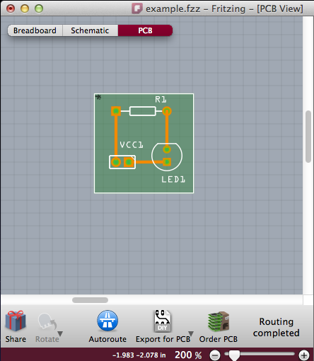

I created a new project called GerbPaintSCAD that will take a RS-274X extended Gerber Solder Stencil and convert it to an OpenSCAD file.
This is very preliminary and hasn’t been tested against anything other than very simple PCB’s designed for Single Sided in Fritzing. It requires the ability to run Ruby 1.9.2 from command line.
