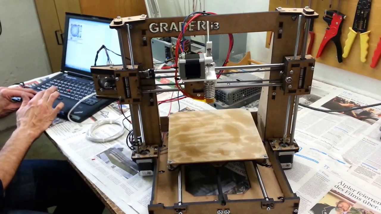

Not yet printing but the steppers are working! ![]()

@Shane_Graber as the author, pray tell - is your frame assembled on nuts&bolts only? No glue or anything? How does it behave after 50 hours? I mean, I am reading all kinds of stories about wobble, about plywood expanding/contracting with humidity etc. - you know, problems with geometry.
@Igor_Larine I’ve had mine assembled and running for a couple months in my basement (humidity ~ 50% using a dehumidifier) and have not had problems with warp, wobble, etc.
Yes, it’s assembled with nothing more than nuts and bolts - no glue of any kind.
I’ve printed at least 40-50 hrs now on it and have had no issues to date with it.
One thing I did do was drop my Jerk from 20 to 15 and my Acceleration from 3000 to 1500 and that really helped with print quality.
I also placed cork motor dampeners on all of my steppers, which significantly decreased resonance noise coming from the frame.
