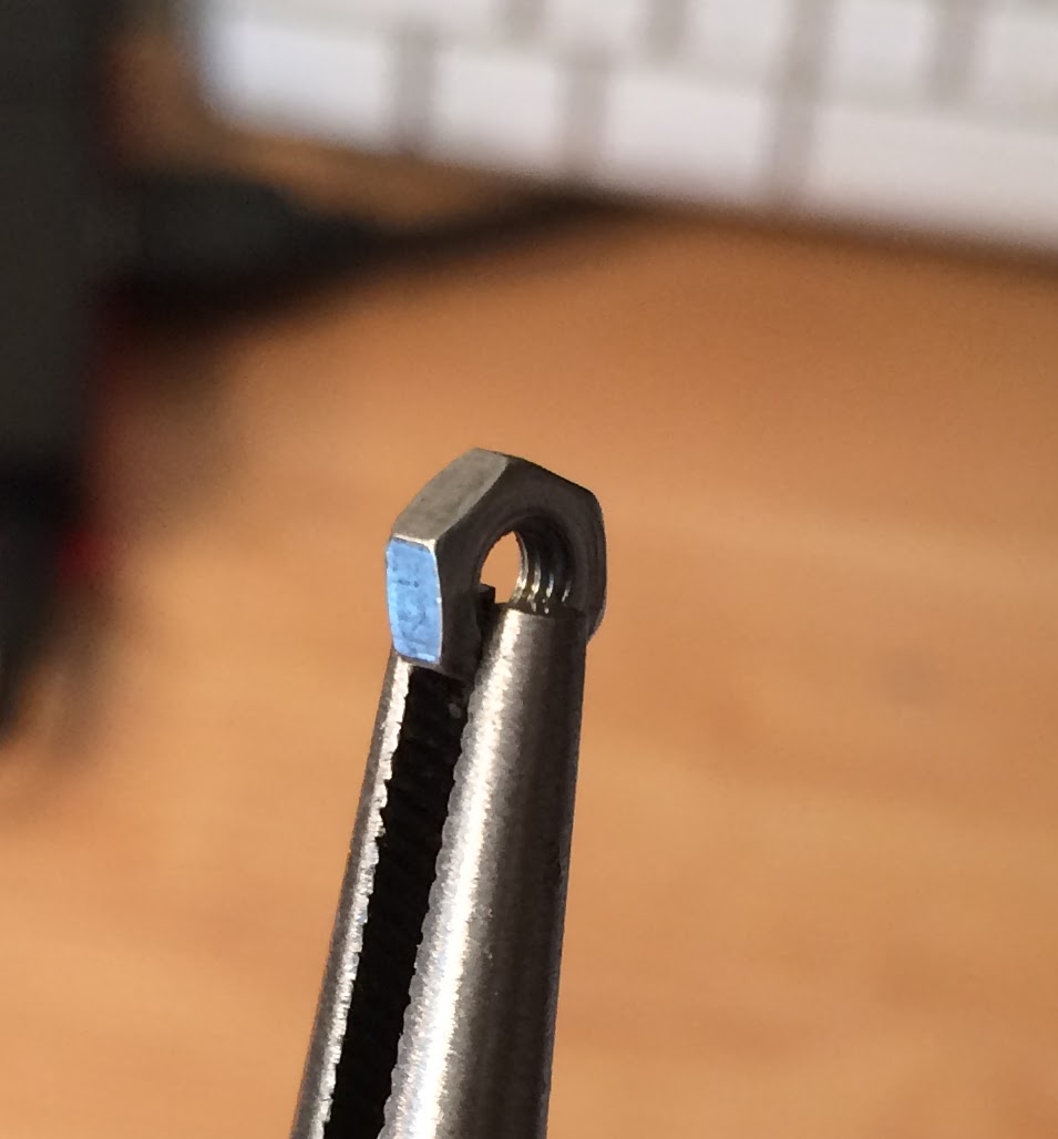

Note to future Printrbot Simple kit builders. A pair of super narrow needle nose pliers will make life a lot easier when inserting the M3 nuts.
Something like this is pretty helpful as well https://www.facebook.com/photo.php?fbid=654150004635425&set=a.654149881302104.1073741854.595124113871348&type=1&theater
I use hemostats purchased at surplus store. Nice because they clamp and lock. http://www.amazon.com/SE-Hemostats-Curved-Straight/dp/B000W1Y9YU

Hemostats work great on the lasercut bits.
