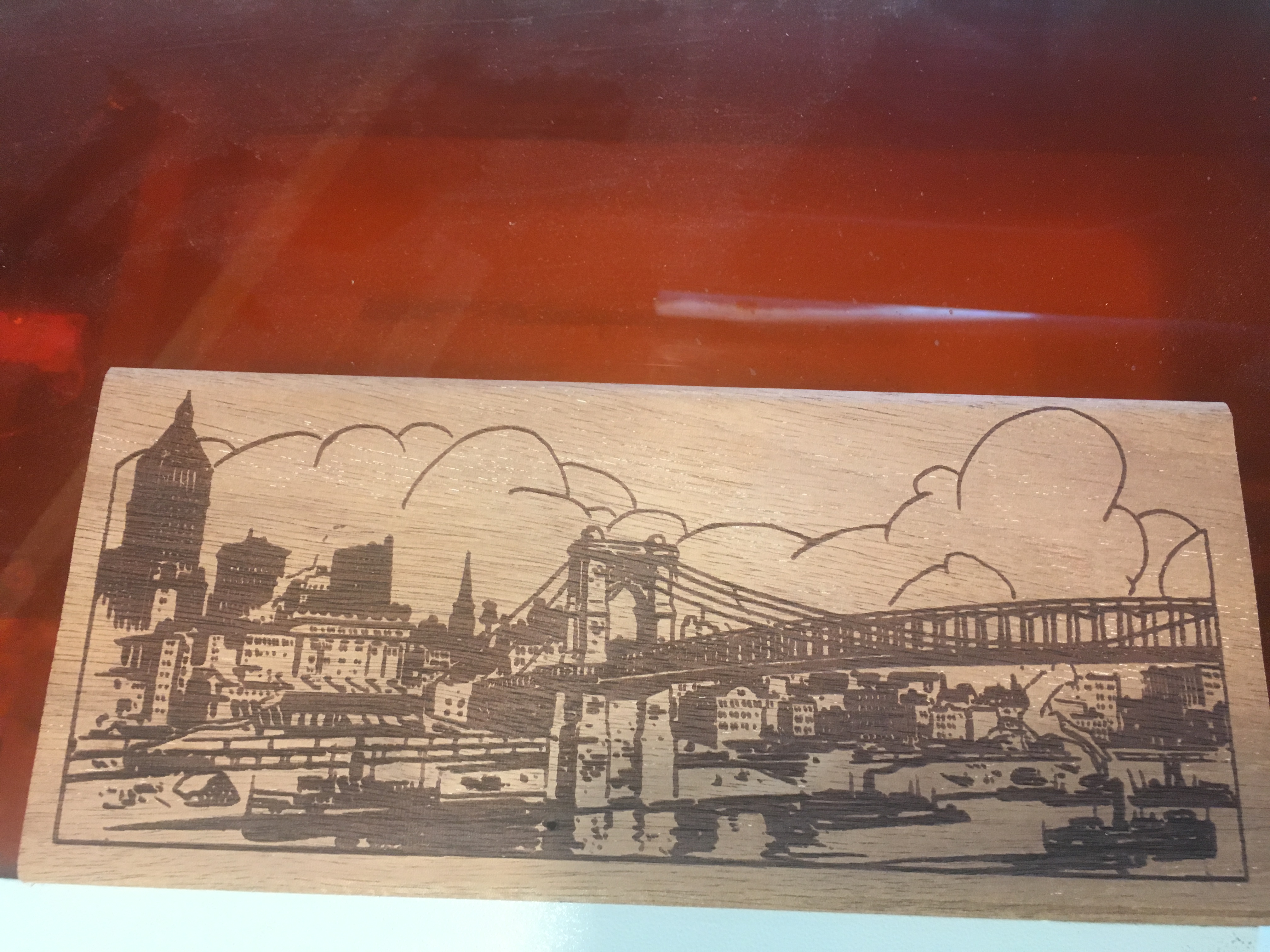

Nothing takes laser engraving like true Mahogany.
Add some DRAMA!!!
Hi, may ask what settings did you use to engrave it. Speed, power etc ecc, thank you.
@Mike_Gallo This was 150mm/sec 15% on a K40 with a TRUE 40 Watt tube. The image is an 2-Color (B&W) Pen and Ink Drawing.
