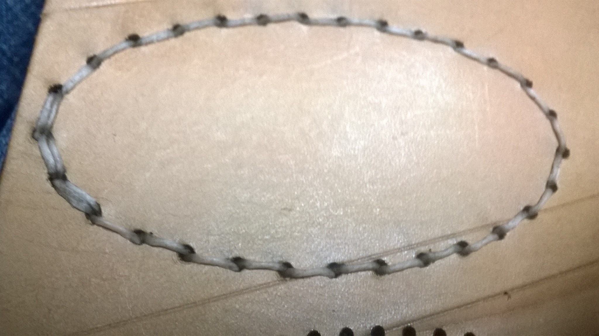

Now that I’ve got my laser lens up the right way I can actually use the laser cutter for what I purchased it for: punching stitching holes in my leather (I really hate doing that). So here is a test of it on some 2mm thick leather. 7mA @ 7mm/s Cut. I then stitched it afterwards.
Basically I created a pattern brush in Adobe Illustrator with 1mm circles, spaced apart @ 400%, add space option selected. I then just choose it as the brush for the outlines of whatever shape & voila, it creates a precise stitching line for me to stitch.
Only issue is slight amount of soot in the holes discolours the thread as I stitch. Possibly not an issue after I dye & lacquer the leather though, as the soot will be “set” into place.
