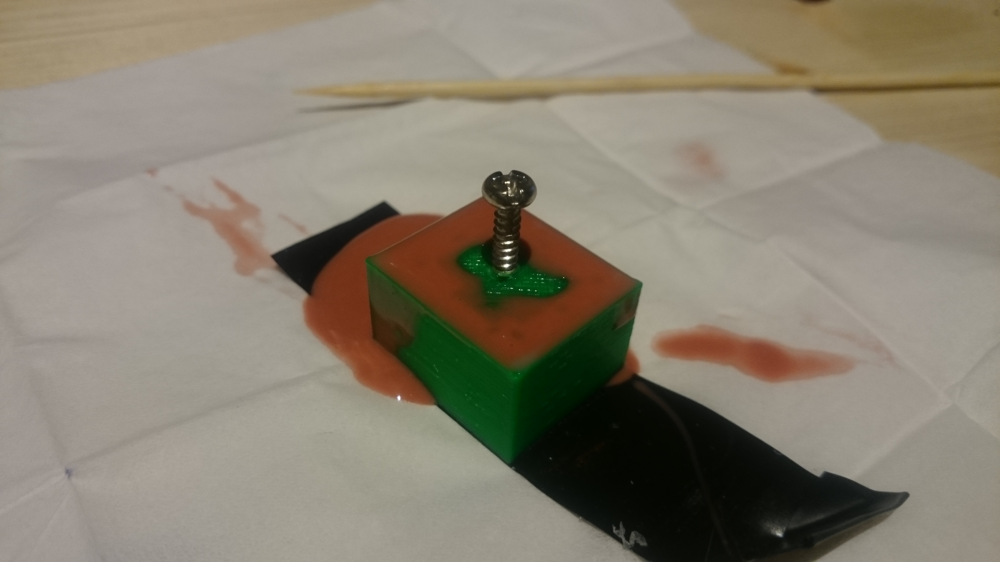

Now thats the molding silicone i need ^^ e3d hotend cover
e3d hotend cover
Did you put any kind of release on the plastic?
@Daniel_Kruger Well no ill try without first :wink:
What kind of silicone did you select?
what did you end up using?
@Tom_Keidar
Its moldingsilicone for TinMolds. 350°C+ and reaaaally runny :wink: Got it from ebay (germany)
@Tom_Keidar Any silicone made for making casts for tin or other low melting metal is fine. They are made for up to 450°C and are very viscous. I’m german, so I don’t know the exact brand you should choose in the usa, but google with the information given should work, too :wink:
@Daniel_Kruger You don’t need one, if printed in ABS or PETG. I don’t know about PLA…
And scrolling through this thread: http://forums.reprap.org/read.php?252,584458 and just downloading any provided STL should show you some of the best casting molds the german sub-forum came up with :slight_smile: Especially the one of user “dolphhund”.
@Tom_Keidar its from ebay BUT here is the website of them: http://www.trollfactory.de
If provided this link by @VolksTrieb , than I recommend the red one. I did also some postings about exactly this stuff: http://well-engineered.net/index.php/en/component/tags/tag/9-silikon

I’d love to see pictures of it installed. I’m thinking about adding one to my hotend.
@Daniel_Kruger
No need for a release agent at this size. Despite the rough surface.
How is it working out? Improvement?
Well the model is not that good.need to redesign it a bit. The burls on the silikone are in the way somehow
