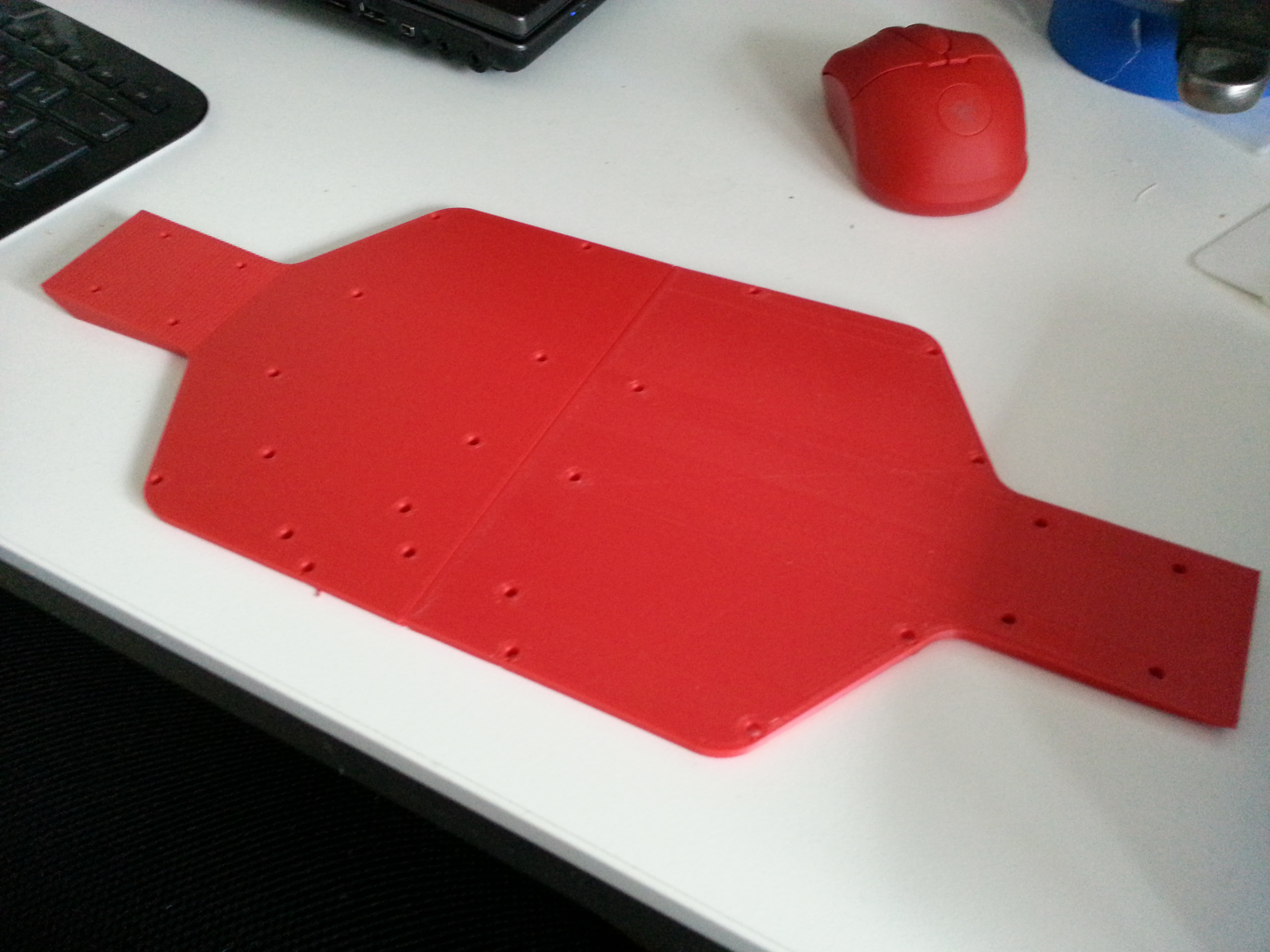

Number 2 on the way. This one will be a 2 color combination which will have nicer look to it…
I’ve am going to build a large-bed printer soon (about 1 square meter) and have been pondering building this as 1 print, but I think I like the fact that half of it can be replaced if it breaks. Much quicker to print the replacement part, and more likely that somebody is just going to have one sitting in a box with them on ‘race day’.
@Mike_Creuzer I nerver thought of it that way, I only cut it to fit on the build plate but that’s kinda clever!
