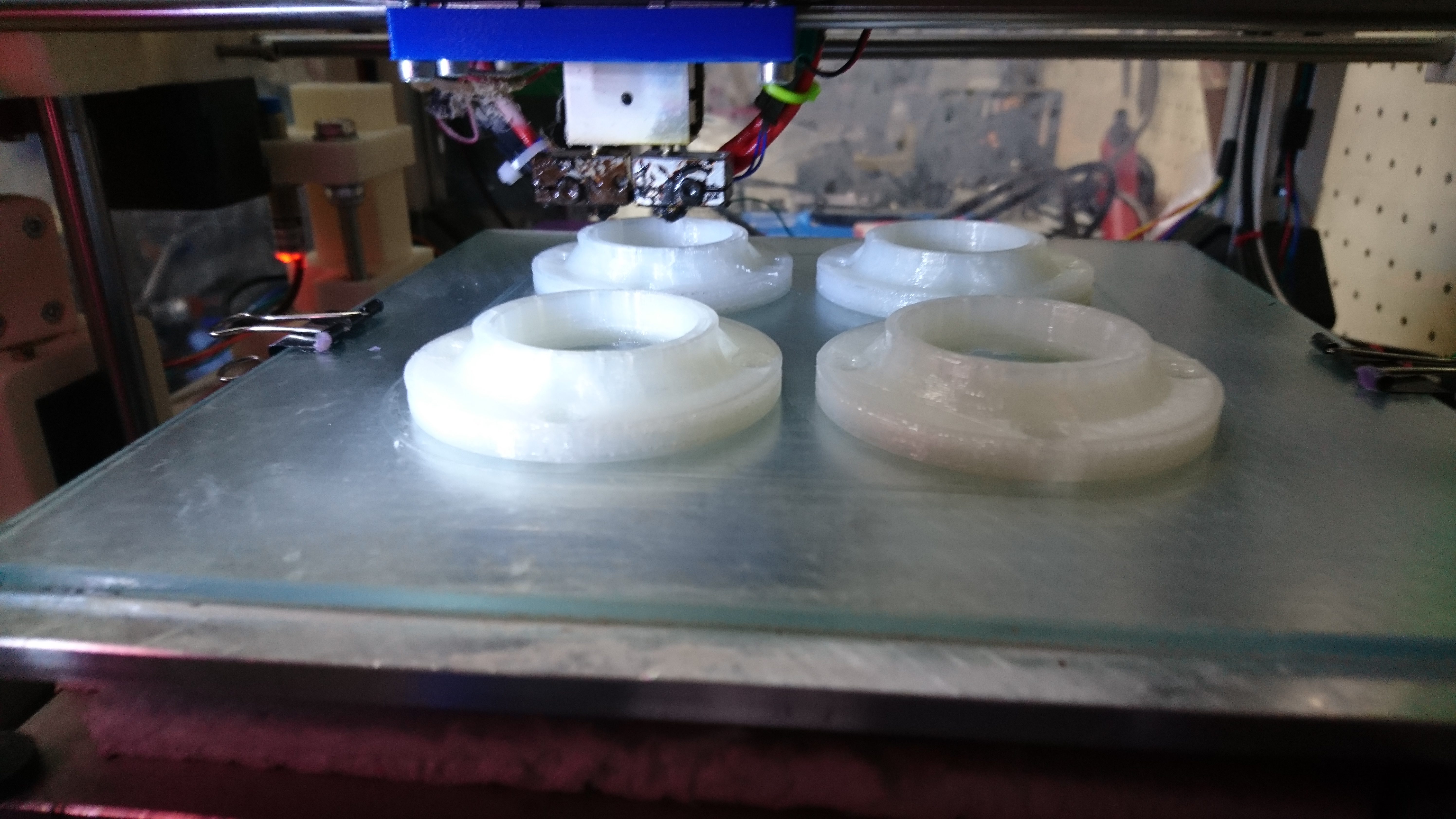

Nylon on Elmers Glue.
Nylon on Elmers Glue. I love elmers glue
Gotta make sure it’s the purple stuff, I found the white washable stuff doesn’t work as well.
^---- Yup. Love the purple. I never bother with tape any more.
Undiluted PVA, spread as thinly as possible with a brush works perfectly as well on glass and on the the Prusa i3’s matt PEI. 45C bed.
