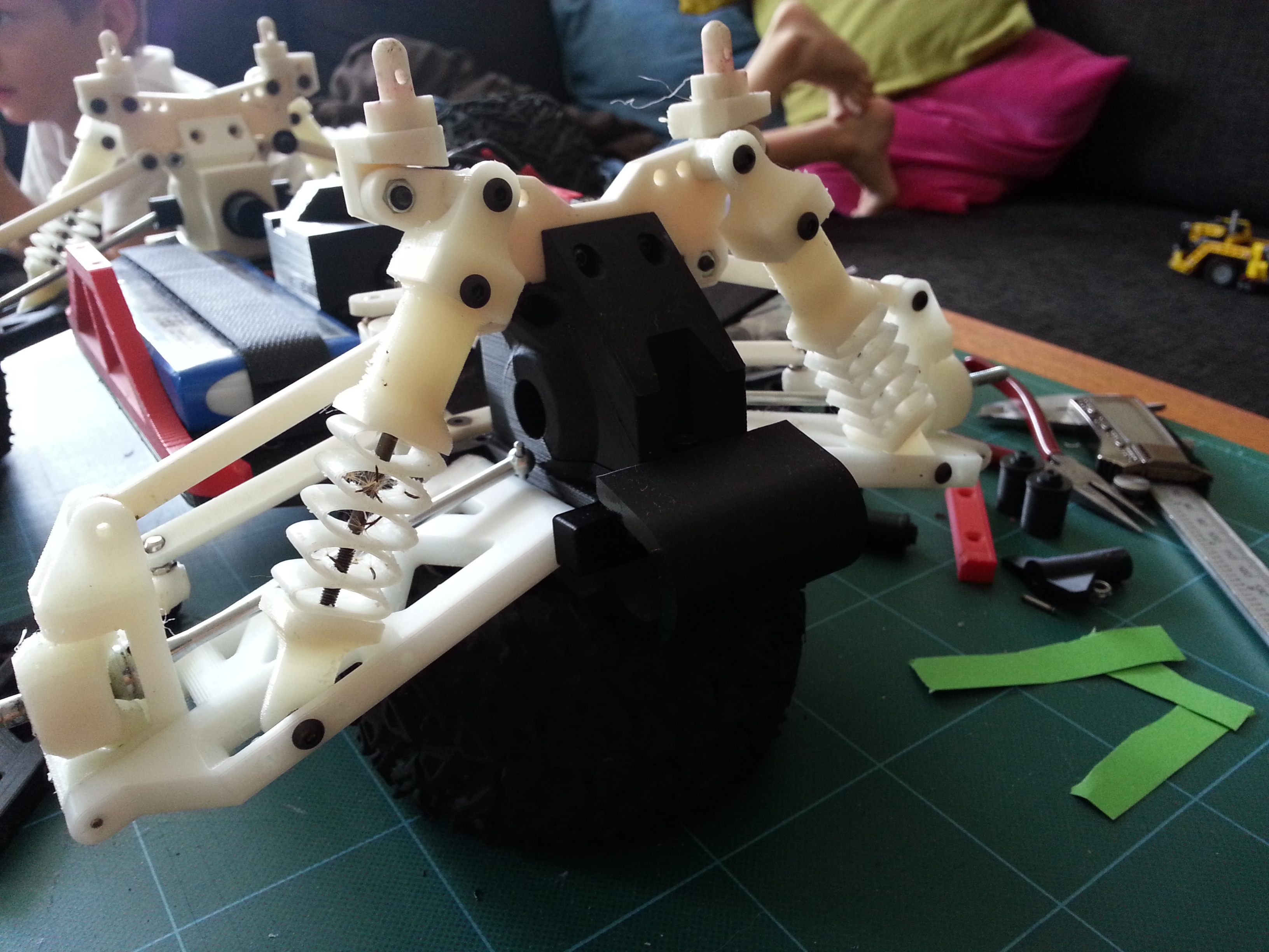

Nylon wishbones in place. Slowly making my way to a test drive....
Nylon wishbones in place. Slowly making my way to a test drive…
Looks good, haven’t had a failure with the wishbones yet. The spur gear on the other hand broke it’s teeth far to easy in ABS i’ve replaced it with nylon yesterday. After that promptly one of the metal outer driveshafts broke. Maybe I need a slipperclutch somewhere.

is that 3d printed?
@Luca_Wright Yes.
OK thanks, I spent some time reading your other posts. Is this 618 Nylon from http://www.taulman3d.com/ ?
@David_Galloway that’s right. They are crazy strong!
