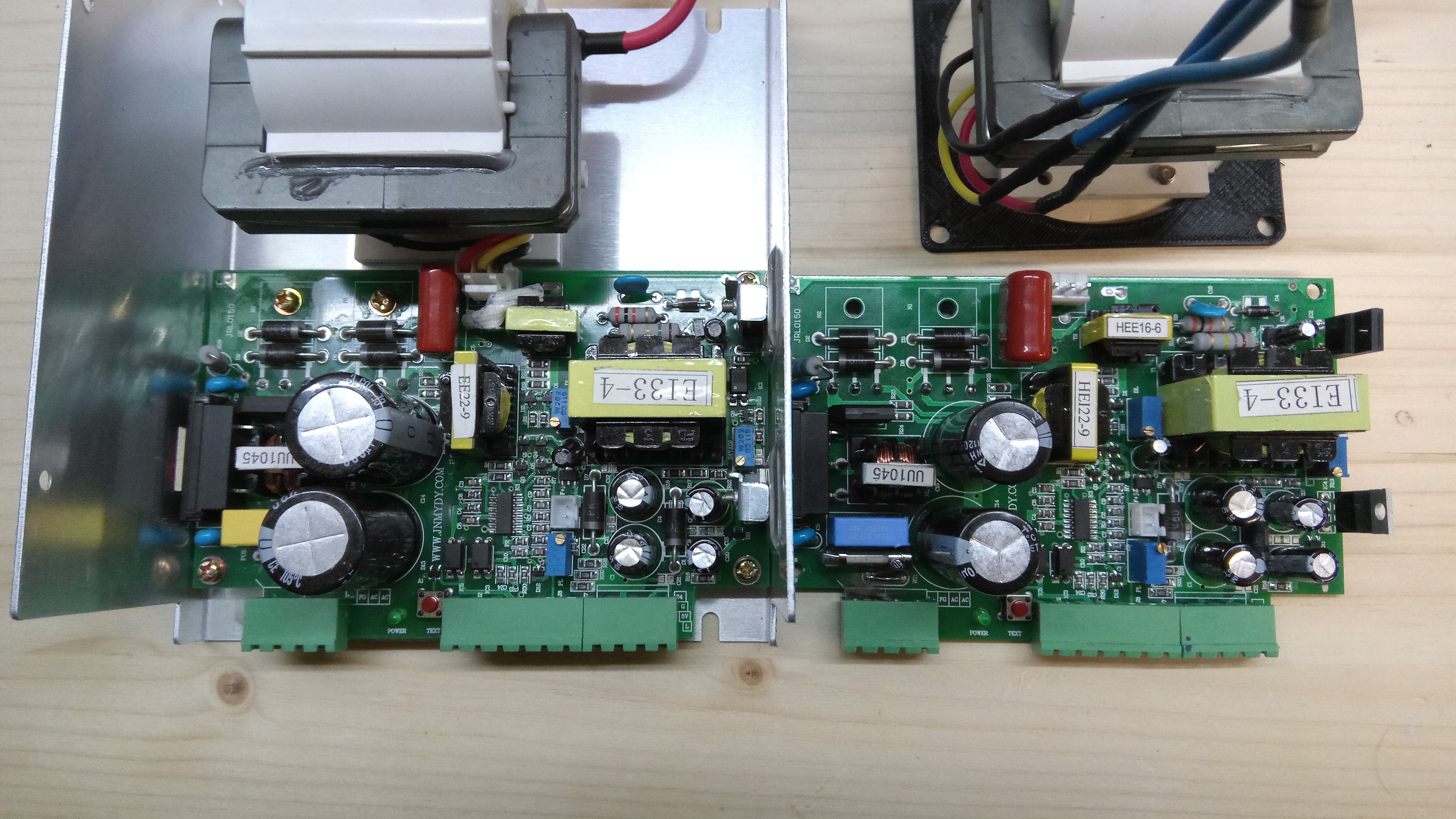

Τo whom considering to upgrade the power supply..
Τo whom considering to upgrade the power supply…
In left side it’s 50w PSU and in the right side is 40w PSU … can you spot the difference?? there is no difference in the board even have the same part number …the only difference is in the High Voltage Flyback Transformer.
So if you want to upgrade from 40 to 50watt you can only change the Transformer with the bigger one (cost 20-40EUR) than change the whole PSU (cost 90-120EUR).

Visually the two larger capacitors are bigger on the 50 watt psu, what differences are there in the ratings written on each? You may find the larger caps are resonsible for helping with the initial firing of the laser, which takes more current than keeping it running once it is firing. Hence the larger size on the 50 watt psu. Just to say it, for those not electronically minded I would advise caution modding your 40 watt psu, at these voltages it’s best to be safe than sorry.
@Ian_C The difference between the capacitors is 90μf (50w is 560μf 220v and the 40w is 470μf 220v) i think the difference is too small. As for the size of the psu is exactly the same. Another part that i notice is different is the rectifier module in 40w the part no. is KBP310 and to the 50w psu is KBP206G…
Good catch guys. Those caps look like filter caps on the offline switcher not the HV flyback switch. These differences may simply be changes to improve the supply’s reliability. Both these parts are common failures. NOT … the KBP310 is 3Amp and the KBP206G is 2A??? Also the 220V rating on these caps seems marginal especially in non-US use cases.
