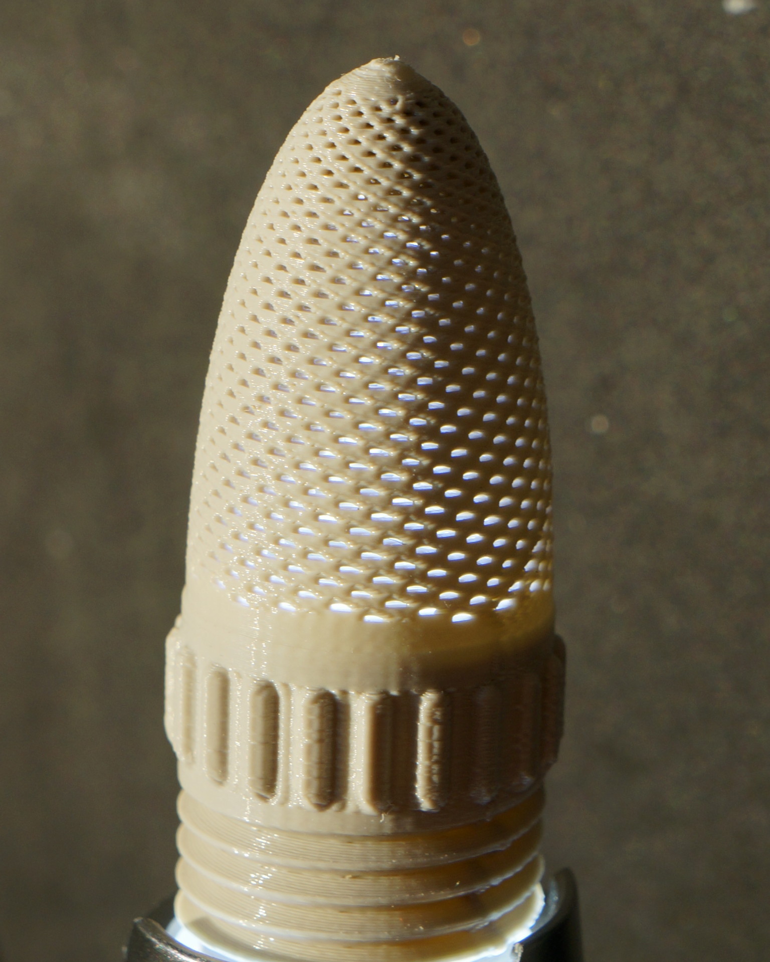

Oberflächenstruktur d197|17
turns out that you can have a nice lattice pattern on spiral prints by making little incisions. These are based upon the golden ratio φ, 3 on each layer turned ⅓ of 137.5° the golden angle, 2 layer high (2×100µm).
Now it looks like a sextoy
@Sebastian_Schmidt lol.
So, Ahem!.. What is it actually for?
@Duncan_Gunn it looks like something you would put on a hose to water a garden or something.
@Kevin_Danger_Powers you’re probably right of course. I liked the idea of spiral prints too, but don’t use it much because it seems to upset slic3r.
