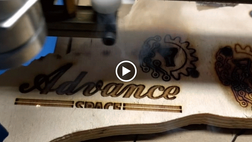

Officially back in the laserWeb game. My lasers where against me for a little bit.
Running a K40 with @raykholo 's COR3D Smoothie board remix and sd6128 drivers from http://panucatt.com
The last picture was ran at 128 microstepping, 7000 acceleration, 500mm/s with raster code produced from LW3 and ran over USB. It only buffered once, which was impressive for the speed and amount of code. The video was considerably slower…
FOSS ftw. Thanks to everyone who has been putting in the hours while Ive been down. Excited to be back at it.
