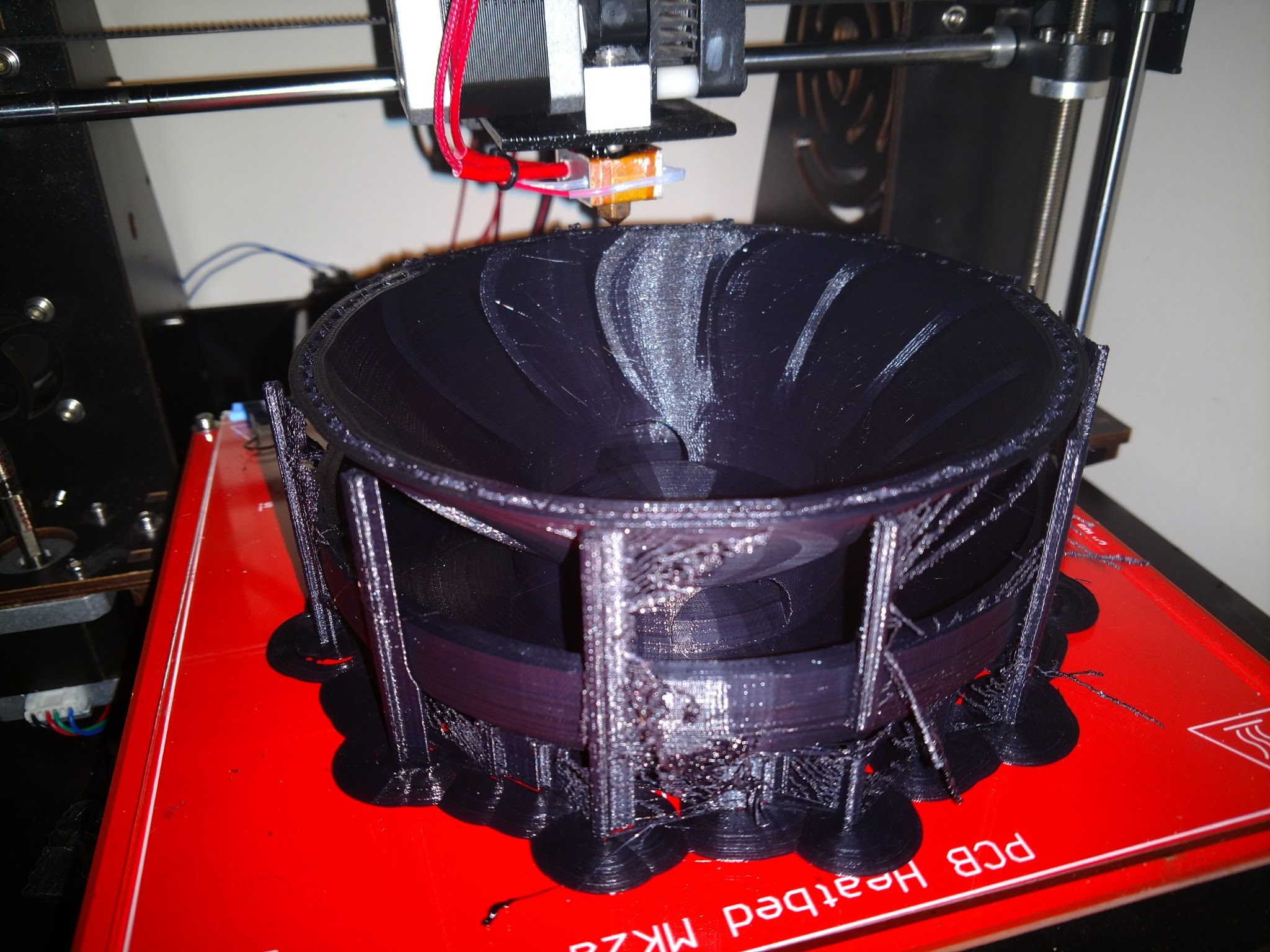

I just realized that I made a wrong calculation… I think Cura said this print was going to be 4 days and 8 hours… I think I added 48 and 8. Obviously there are 24 hours in a day, not 12. This would make this a 104 hour print… Well then you factor in that I boosted the speed 50% and I think we’re looking at more like an 80 hour print! This is taking forever! Lol. I should have done some stuff to make it go faster. It didn’t need to be THAT smooth.
Also the heater wires on my print bed broke so I have no heat and it’s possible that the part could just pop off and screw the whole thing up. That would really suck as you can see that I’m over 55 hours in…
The start of a “56” hour print, my longest yet. Let’s see how it goes… Fingers crossed!
I’m now at 55.5 hours and 64%.

What print speed and material?

@Adam_Steinmark it was set at 30mm/s but at 150% and I’m using PLA. But it’s almost completely solid and it’s printing at a .01mm layer height.
Why solid? And set it to 50-60 mm/s at 100% feedrate.

@Adam_Steinmark ​ it’s not completely solid but the walls aren’t super thick and there is going to be liquid in it so I didn’t want it to deteriate super fast. Also, I can’t print that fast yet (maybe not at all) because I have a cheap printer. The seller actually recommends 35mm/s. As I get it more dialed in I’m sure I’ll increase the speed. I’d rather it come out right than finish fast and look like crap. Also, I had originally set it to 30mm/s and decided early on that I wanted it to be faster so I just turned the dial up. Normally I do print at 100%

You’re already printing at 45 mm/s, an i3 frame can go up to 60 mm/s, faster with a metal frame.

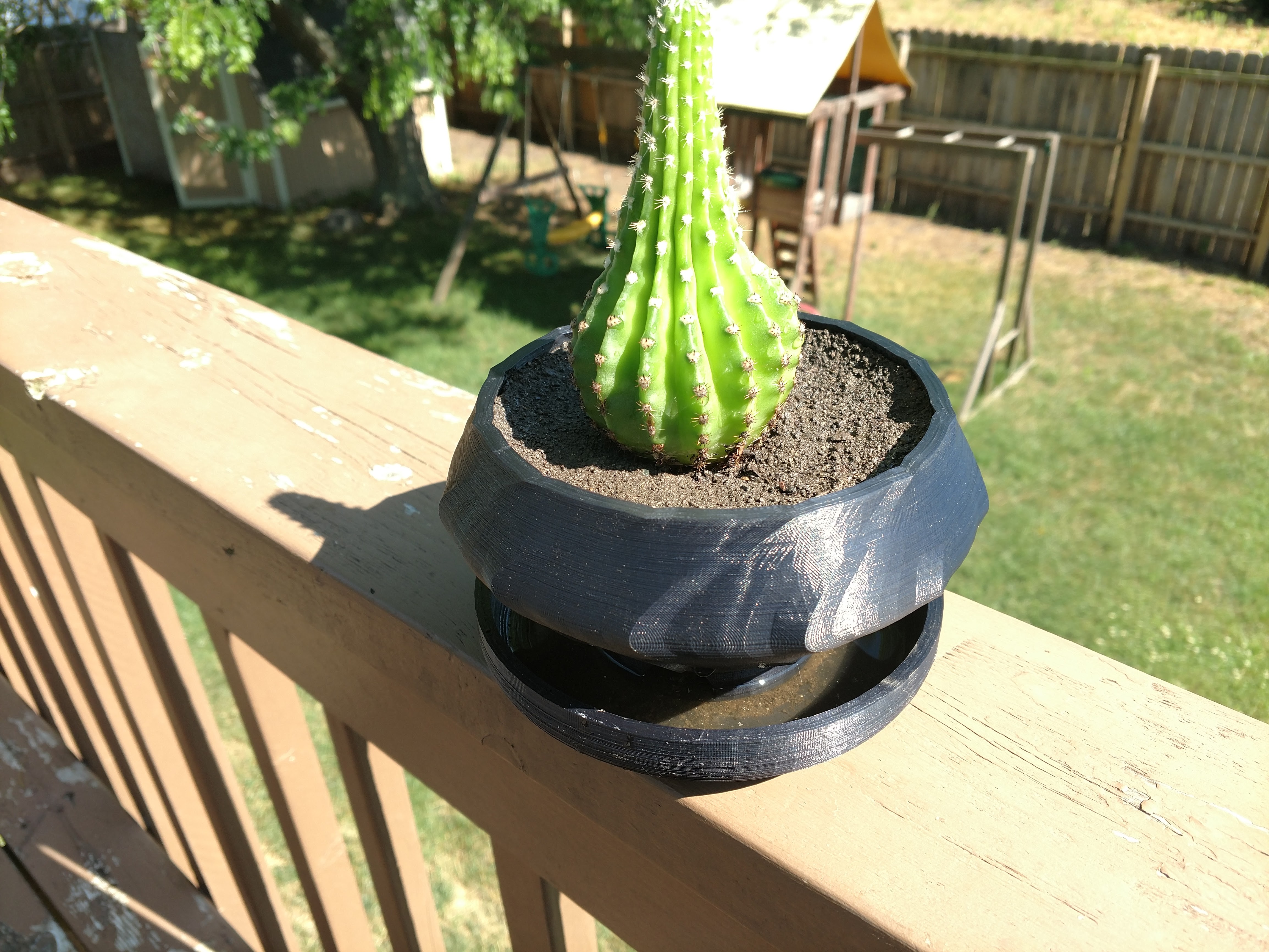

What is it?
@Jake_Smith It was a cactus pot.
