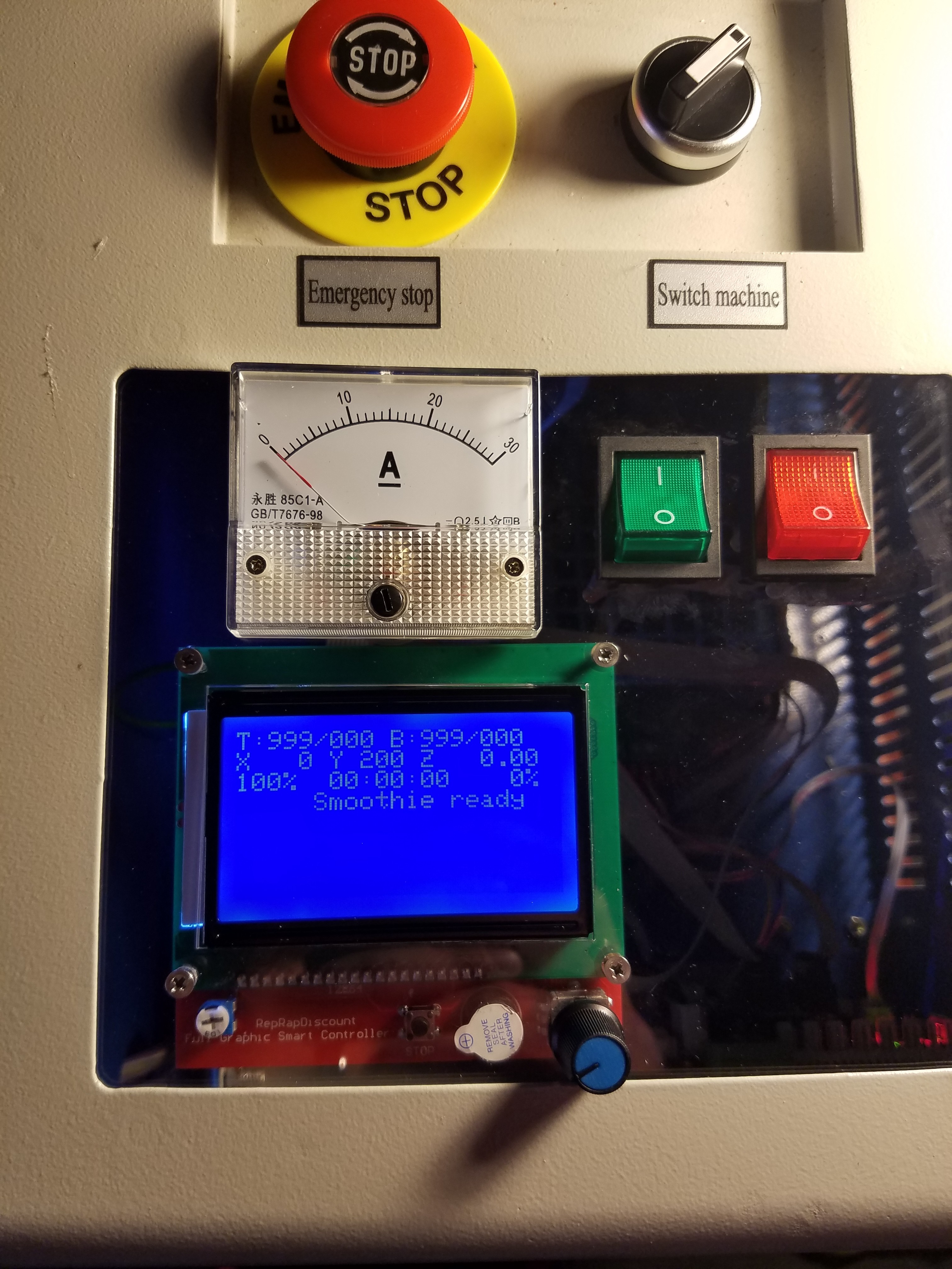

When I got mine never thought I would have done half of what I have done to it. But the software is just so bad lol… It is my last leap of upgrades as I finished my manual adjustable bed, air assist and laser guide for focal adjustment. When I seen the listign this was supposed to be the latest and greatest k40 around, that was before I learned of this group and what the k40 really had in store for me. heh… @Nedman
I did take lots of pictures and will be doing a write up of it when I get close to finished.
Small update, got it installed, and laser web working with it. First test was a little hot, will take some experimenting now to learn the ins and out of new software. Will now put all the pictures I took of the install on the computer and do a write up of the process I required.
My current write up. Will be changing as I go along. https://docs.google.com/document/d/1f4u79SzF7th84rFIfUXIpY8u4YEpwoGeH7z-K8yjxQc/edit?usp=sharing

Wow, sorry slow reply!! No, I left all endstops as is. Only part I swapped was the board.
