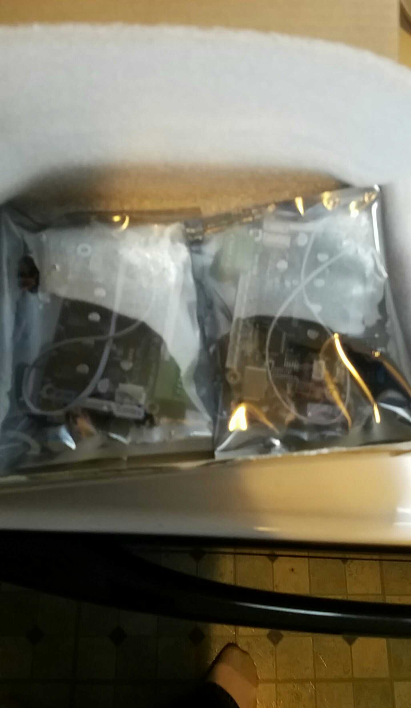

Oh ho ho lookie what I got in the mail today.
My friends and my C3D mini board.
Will document the install from a noobie point of view.

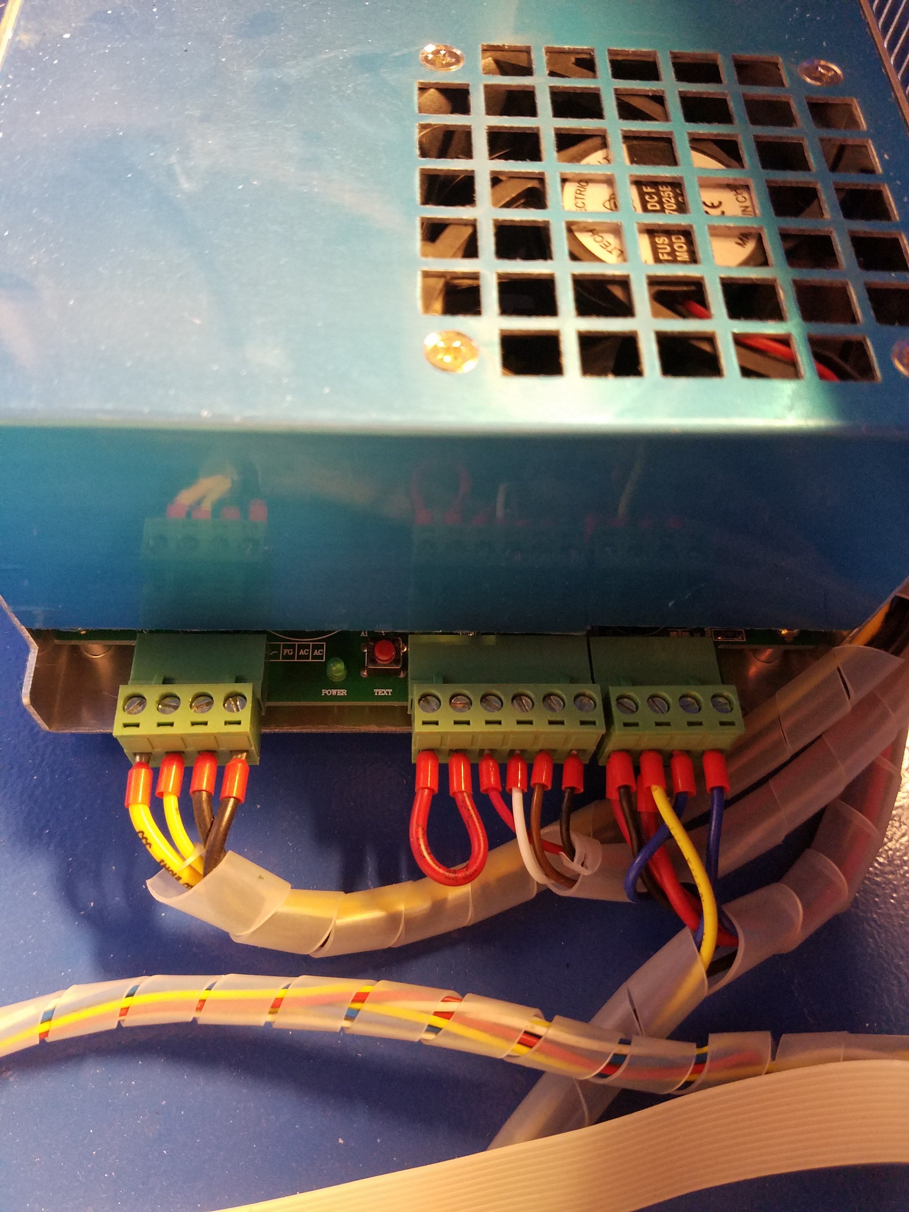

Can you put a photo of your psu on
please as I need to order one up and I’m not sure which one to go for.
@Andy_Shilling . Here is one currently on my phone.
Thank you, that looks like the one I am going to get, I was just concerned about the connections as some have the white connectors and others the green.

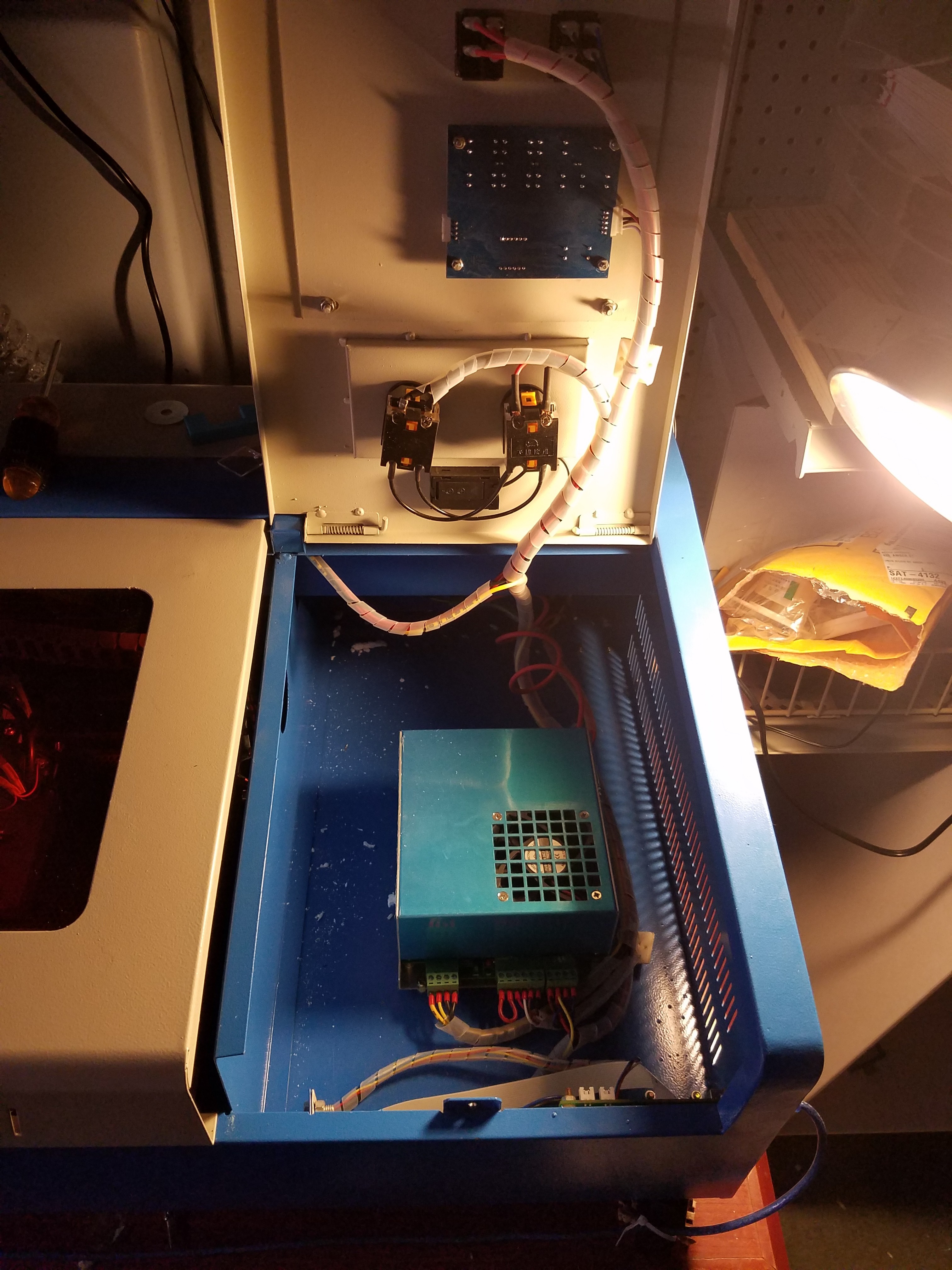

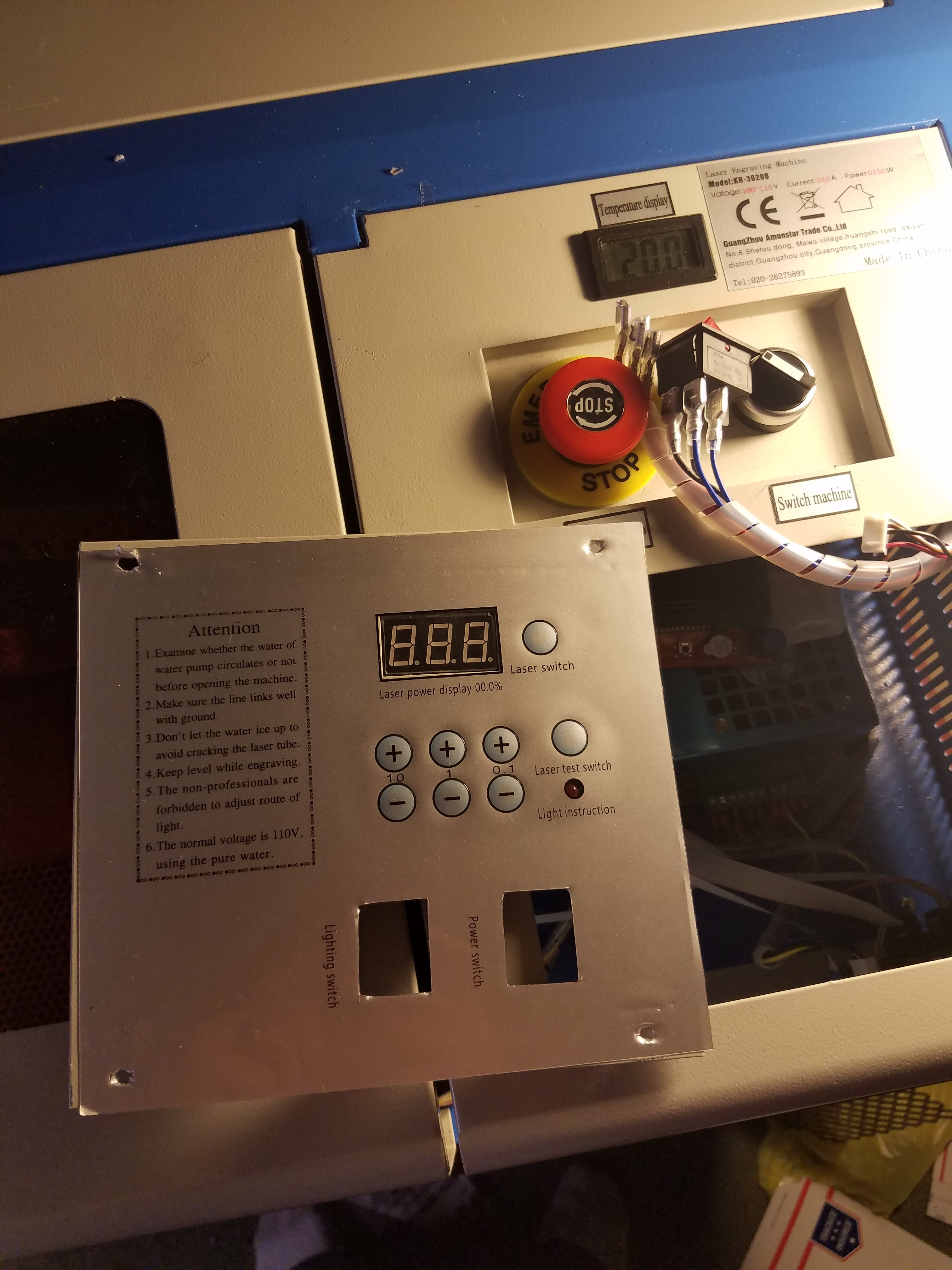

So, to recap today’s progress for the viewing audience (Hi Andy and Ned!)…
Kelly’s laser is a slightly different one… The power on and off operates differently than how we’ve seen before - so when one switch is off, the 24v at the power connector is off, and that means that the Mini can’t power itself. This is what the earlier “usb power and glcd concerns were about” as well as the current one which we will figure out later.
If there’s a lesson here, it is to order the simplest k40 possible. These LCDs and niftier buttons are complicating things slightly. But we’ll figure it out, we always do.
Hmmm, judging by the pics Kelly posted above I’m pretty sure I have the same model. So he’s definitely my person to follow for this upgrade. All I have offer in return is moral support at this time, so go Kelly go
@Nedman do you have any sort of LCD panel on your machine? B/c Kelly’s psu looks just like the rest but the top panel is a whole different story.
@raykholo Yes, I have an LCD for the the laser power display instead of the current meter found on other K40s. The underside of the electronics panel in Kelly’s pic looks the same as mine
