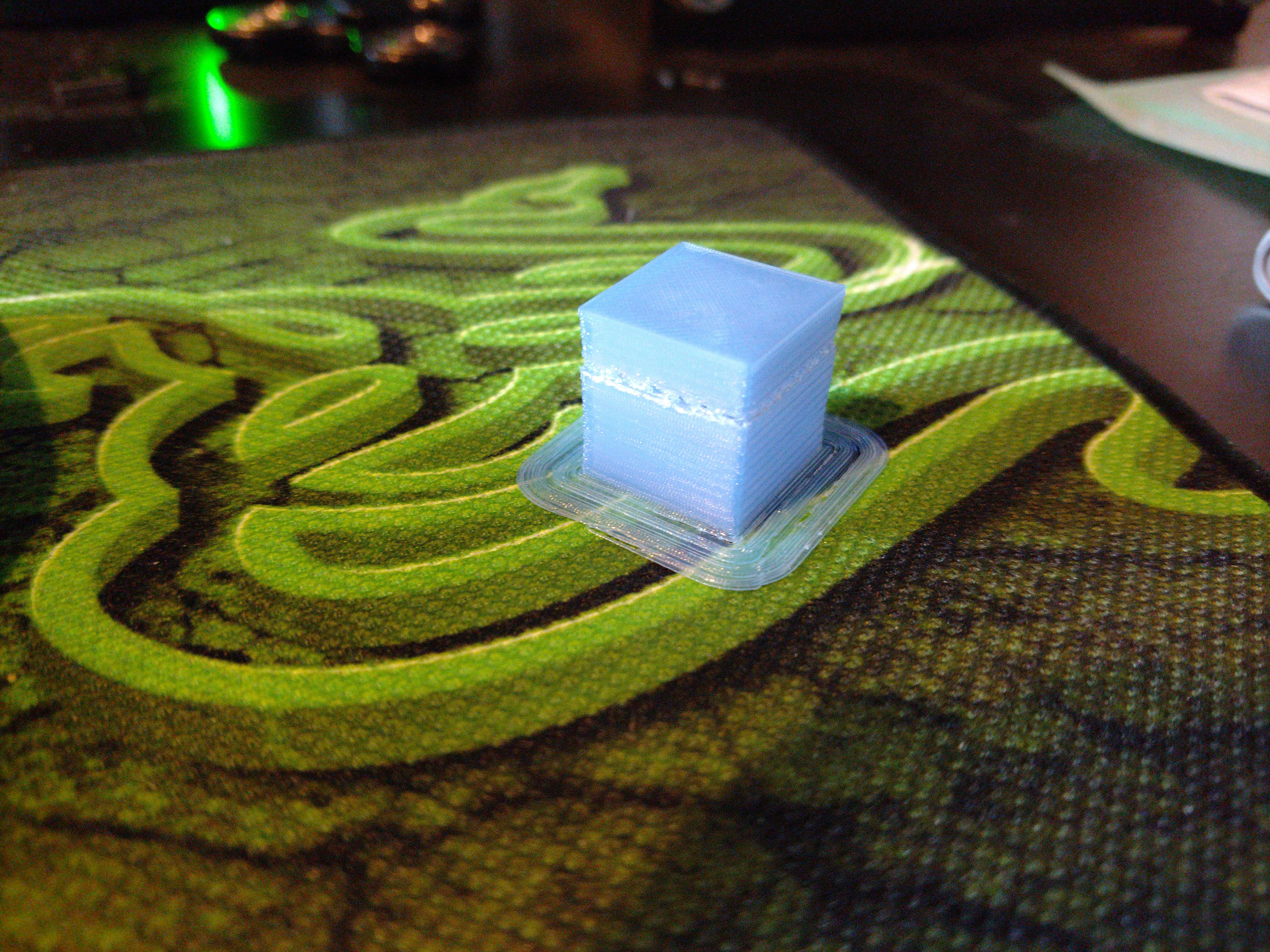

Oh mighty 3D printing gods, I have a new problem.
Oh mighty 3D printing gods, I have a new problem. So I have tweaked a few settings and I’m finally getting some prints out but I’m having an issue with the filament coming out. For the most part it’s fine but every so often the extruder “pops” and the PLA won’t come out. This of course leaves gaps in the plastic. Is there anyway​ to prevent this from happening? I can’t seem to find any adjustment screws so I’m kinda at a loss for how to fix this. A guy at work said that it could be that the filament that came with my printer could be crappy and not held to a tight enough tolerance so the gear is skipping. Is my only option new filament?
