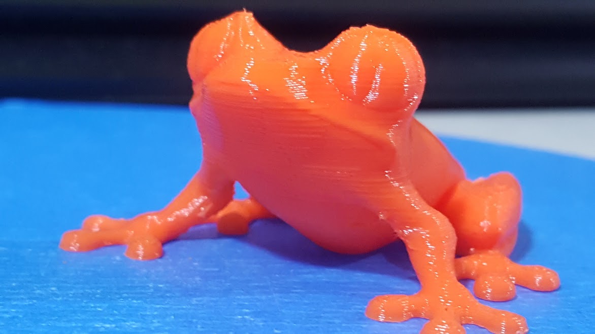

OH MY GOD MILTYKOSS IS WORKING SO WELL!!!! I put the stronger spring in
OH MY GOD MILTYKOSS IS WORKING SO WELL!!! I put the stronger spring in the extruder, cleaned out all the remains of the clear ‘PLA’ or whatever it was, and went back to Hatchbox orange that I have a lot of experience with.
There are a couple of issues still that I think are from switching to S3D because Cura doesn’t support Delta’s anymore. Under extrusion at the top and a blob between the leg and body on one side, but it is pretty way better than I expected!
This is literally the first print on the MiltyKoss using S3D and Orange PLA. Second print ever with S3D the first was on my i3. Right now I am freaking out at a Boaty printing faster and cleaner than my i3 ever printed. Head exploding and I had to post. Video of real time print speed and carriages coming soon.
If you have 1515 Delta you need to try these carriages! So epic there is perfect alignment and zero backlash or wobble. For under $5 per carriage mostly screws and nuts!

Is the bottom a quality test? I can show that, check Thingiverse post I have spammed G+ with my joy of first build and need to slow down for a little while :wink:
