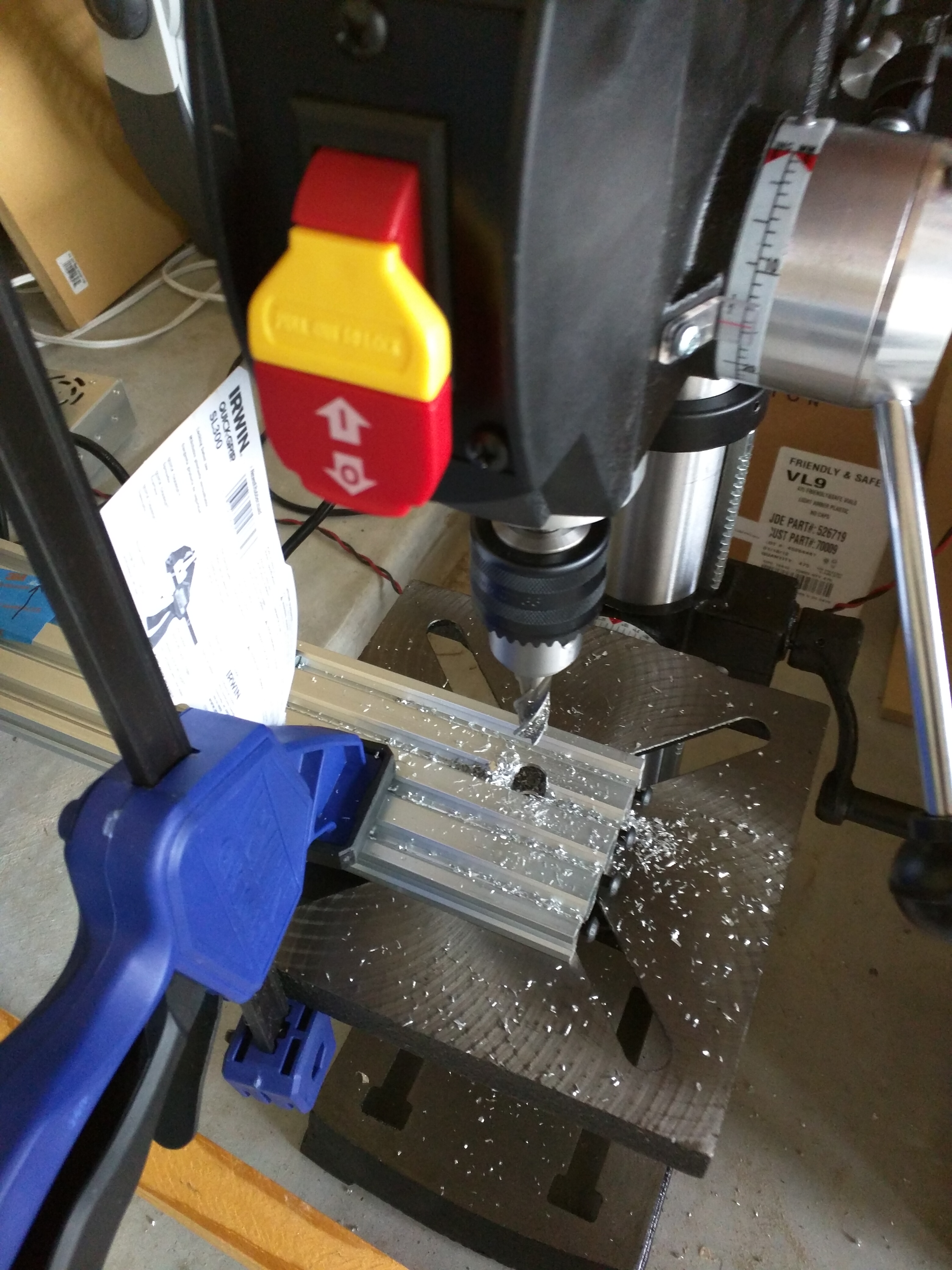

Oh yeah. My first personal shop machine purchase is putting into used. These holes are cleanly made.

Great job. I did mine with a standard spiral bit… And it walked like crazy. Took me 2 hours to drill qty:4 half inch holes. Glad to see someone smarter than me using the right tool for the job!
I got this one http://www.amazon.com/gp/product/B003LSSS0W?psc=1&redirect=true&ref_=oh_aui_detailpage_o03_s00 Amazon has it for $15 off for Father’s Day. I thought, worst case scenario, I spent some money to learn how to use a drill-press.
With a 1/2" end mill (per the instruction on github), making the hole after hand-drill the pilot hole was pretty easy.

@Eclsnowman , I had the same problem - tool supply here in the third world is poor - what is the ‘right tool’? I will bite the bullet and ship it from the US.
@Mike_Thornbury 1/2" end mill bit is ideal (or similar clearance metric bit), or a hole saw bit could work too.

@Eclsnowman You mean a router bit? Like I have for my CNC machine?
I was thinking of using one of my smaller, cheaper Forstner bits for making the ‘clearance’ hole, down to the bottom of the v-groove, then using a normal metal bit for the final hole through the extrusion.
I have one that is just right for fitting an M5 cap-head bolt - 8mm Forstner like this one: http://www.woodcraft.com/images/Products/200/12E33.jpg
I meant an end mill bit like you would use machining: http://static.grainger.com/rp/s/is/image/Grainger/14M956_AW01?$mdmain$
Or a hole saw bit like this: http://images.lowes.com/product/converted/885911/885911105958lg.jpg

My only thought is that I’d clamp it in two locations…keeps it from pivoting if the clamping load is inadequate, and makes sure it’s flat with the build plate…other than that, it looks awesome.
(And you’ll want a vice at some point…drill presses love to take parts and fling them into the dark places of your work area.)
@Mike_Miller I am getting two drill press clamps. I got myself a vice but it was too small. So I now have to get another.
