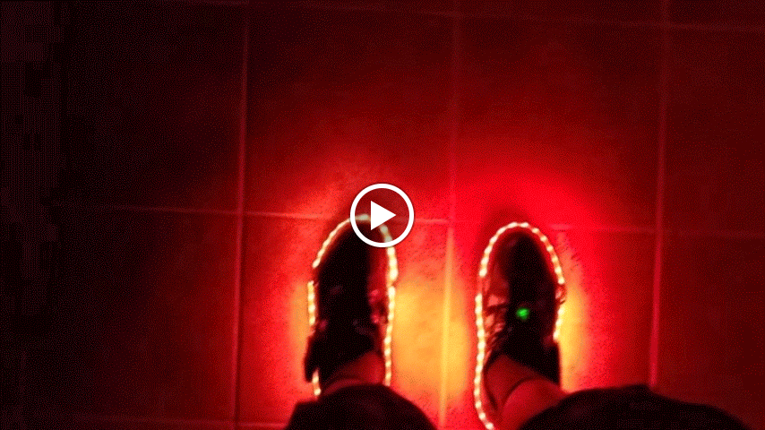

Oh yeah they turned out great
Yeah they did! You can take your own personal disco fun with you everywhere now.
Oh yeah. With matching LED hat and tie lol
Oh yes, the disco fish tie would go great with the shoes!

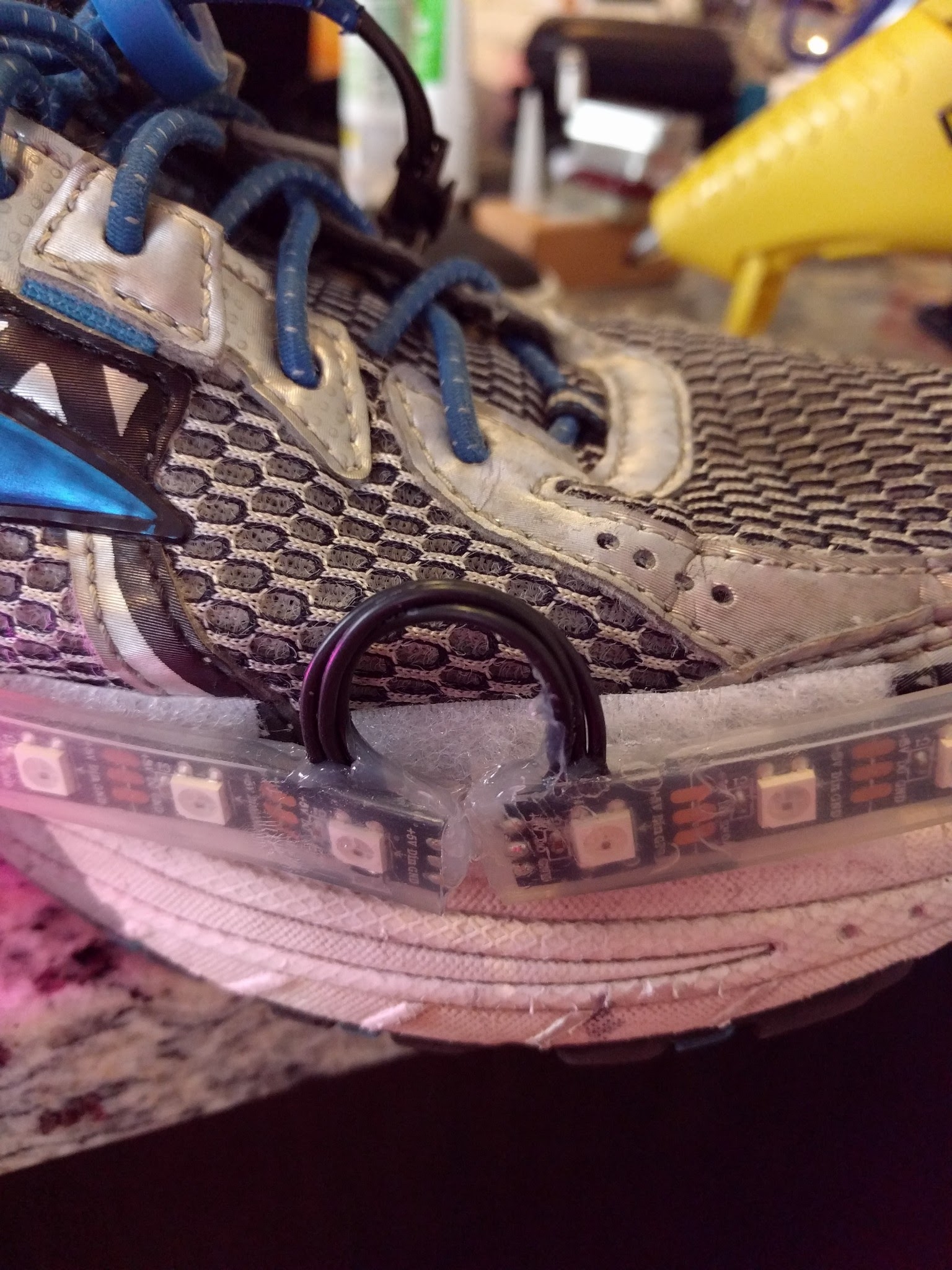

They just broke lol
Data line ripped out on the last segment

Heh, same thing happened to me Cristian
I spent a week working on the same fix for last Halloween only to have the strips break apart after a few steps. I honestly don’t know how the hell Becky Stren manages to skateboard with those.
@Cristian_Martinez have you tried using silicone / hot glue gun for holding down the wires connected to the strip? Although I have never used it for the shoes, I found it makes the connection more durable / stronger
What I ended up doing for my shoes was to mount them using some Velcro spaced along the edges of the shoe. That gave the LED strip a lot of movement freedom as it was “floating” around the shoe, and did not bend with my movements. Con was that it was easy to trip on the strip, but pro was that it did not break after a week of everyday use during burning man. Also was dark, so the setup did not look bad with the darkness. They looked a bit weird during the day.
Well on the plus side the part that broke isnt too hard to repair. Its the last segment of the strip so i just need to trim off the broken LED. Or optionally i could just solder to the data line connection on the bottom of the strip lol
