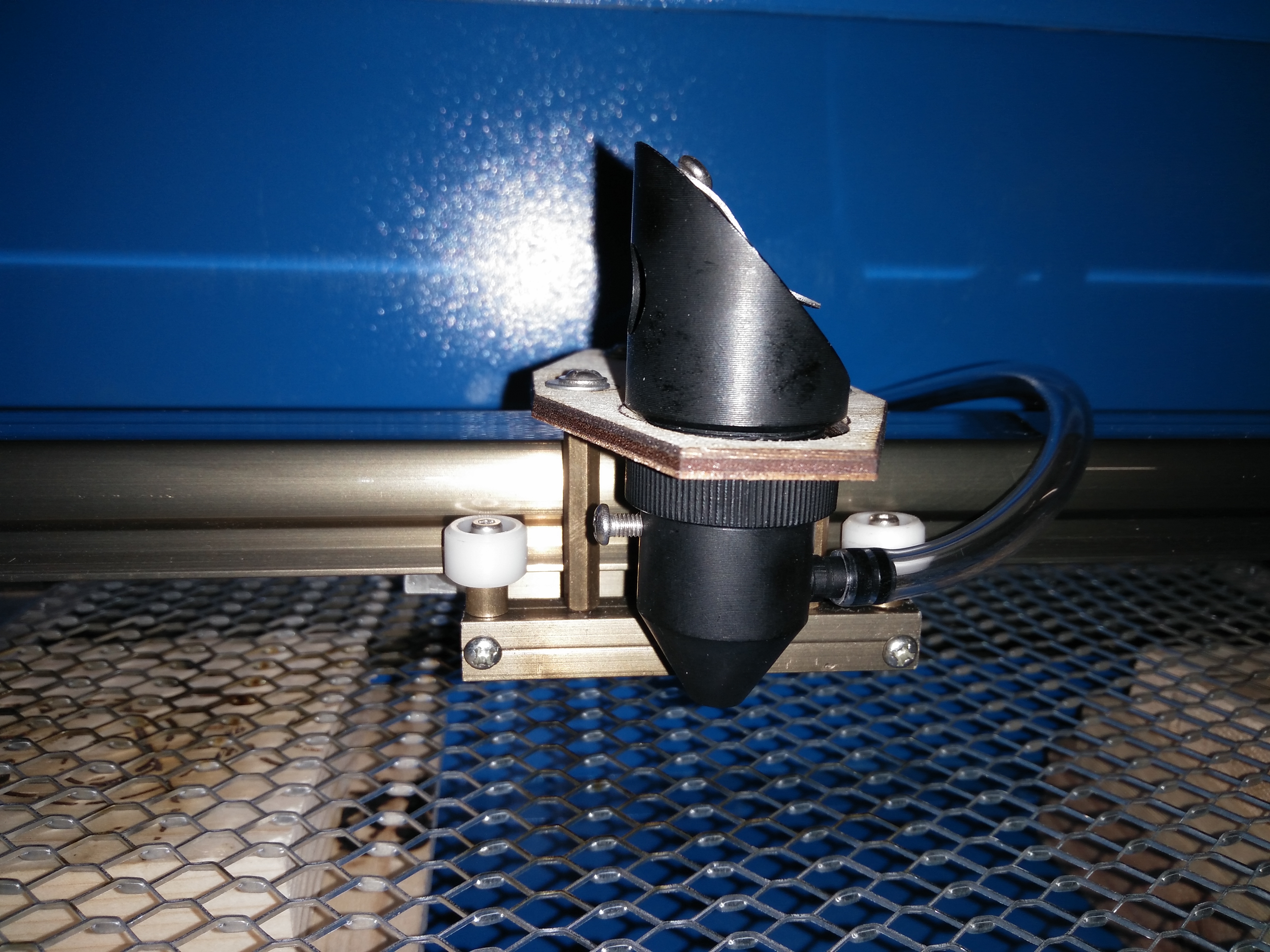

Ok after about a month finally installed the Laser Head from LightObject today.
Ok after about a month finally installed the Laser Head from LightObject today. Had to cut new mount head first because it does not fit in the stock mount its way too big. So instead of drilling hole I decided to just cut mount.
Cutting mount out of wood is not the best idea but its easier than dealing with metal. If you cut one your self see the wood grains they should be parallel to Y axis. Mine are not but got the beam so perfectly aligned first time, I dont want to mess with it.
Air assist does pretty awesome job, I think it helps the beam to cut deeper and cuts are super clean. I guess no more lens cleaning required :slight_smile: .
Interesting. The lightobject head fit my k40 X carriage just right. I got lucky! Just goes to show the variability out there.
@Brooke_Hedrick You know that is what I though too, it should just fit right in there, but got disappointed couple of weeks ago. And then had to re alight the head with laser and mirror a bit to get the beam straight.
Still need to cut the ring that hold the lens right in the center, because stock lens is 12mm and the lightobject head its 20mm i think.
Before I switched to the light object replacement lens that fits perfectly in their head (of course) I just very carefully wiggled the head until the lens sat right. The cutting strength seemed the same as with the old head so I left it at that.

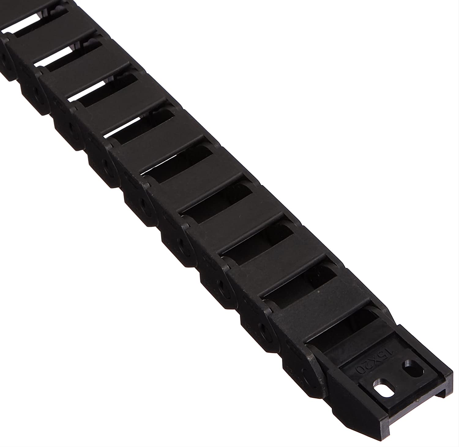

@ChiRag_Chaudhari How is the air assist tube routed inside the box? I tried to use this cable carrier chain but it doesn’t seem that flexible. May be I need to get smaller size.
@Arestotle_Thapa For now Is just hanging in the back of the machine and it passed it through the exhaust vent. Head pulls it when it travels towards the front of the machine and tubes weight pulls it back when the head moves back. Its just temporary, but later I am going to use the coiled tube I purchased form HF.

I had this same issue, are you sure the “top” isn’t actually two pieces?
+1 Nathanial, looking at the pic it seems you haven’t unscrewed the top!
I will check it out later today. But I am pretty sure its all one piece. See the pic no. 4. I may not mess with it for now, as its perfectly aligned. I would rather do some raster testing tonight so they can use some data to perfect the code.
Mine is totally out of alignment so I can take mine apart and post pics if you like for reference
@Nathaniel_Swartz I will sure do appreciate that. It took me 30+ minutes to get the laser shoot straight down through the nozzle so I really dont want to mess with it at the moment. And that made me realize that laser head with adjustable mirror is totally worth it.
@ChiRag_Chaudhari it definitely comes apart, I’ve just received two from lightobject and both are the same.
In pic four, the bottom threaded piece unscrews from the top piece. I’m guessing yours is stuck!
