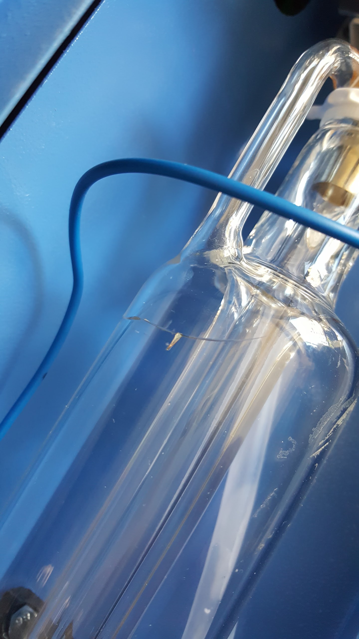

Ok guys. So I got the machine yesterday and started setup. By all means dealing with the software is he’ll, but anyway I had other more important issues. Laser would not fire. Did some checking on all connection without success. Then this morning with fresh eyes I see this. So I can assume it’s dead?

Cracked tube is a dead tube
Looks like a catastrophic failure of the outer water jacket! Bummer Dude!
It hurts so badly. I did send them a message yesterday regarding laser not firing and this morning they replaced asking for videos, etc so I just sent them this picture
Oh man… that’s sad… Good luck getting the replacement, hope it goes fast.

Just to confirm that there are no other issues regarding the machine, if the tube is cracked I should not expect any reading from the ammeter correct?

@Ariel_Yahni_UniKpty ​ try looking for a 30-35w tube that’s what is actually in these machines
Thanks @Alex_Krause ​ would it make sense to get something a little more powerful. What’s the top that the psu can handle
Not sure of the PSU but as wattage goes up on the tube they get longer they make a case extension for larger tube but it’s kinda pricey for what it is in my opinion
