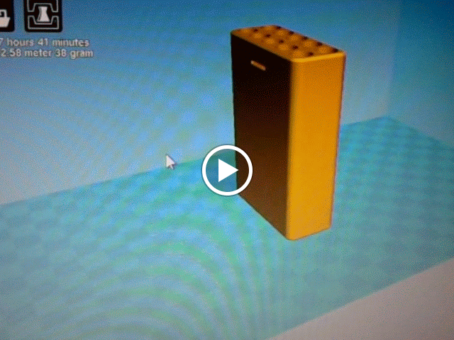

Ok guys. so my X axis upgrade came with the new ATX, everything got assembled quite easily and was on my way to print but then this happened. As you can see in the beginning of the video the print area is defiantly bigger than the original 150mm x 150mm but when I go to home the x axis it only goes by like three cm at a time. same goes for when I am manually controlling the bed and click the 100mm tab after 3cm it wont go any further thinking that it is the max it can go. PLS HELP! I need it working for tomorrow.
