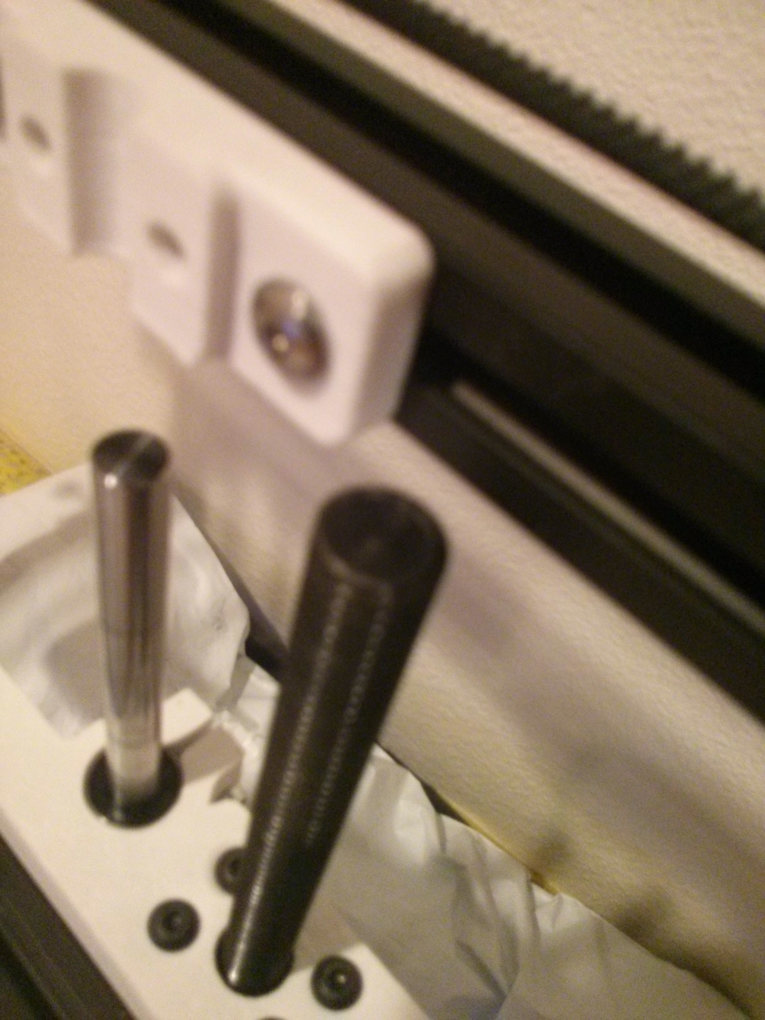

OK here’s some photos. Not sure it helps make anything clearer though. You can see in the photos that the left side smooth rod fits into the clamps perfectly, while the right side is a good 2mm too far over.
Only way I can get the fight side in is to move the top clamp back so the whole axis is twisted which is obviously wrong.
It feels like the bed is too wide but I have checked it against the solidworks model and it is spot on and cut by misumi anyway.
I was also wondering if perhaps the lm10uu bearing in either or both sides is not square resulting in the whole axis being tilted to the right.
I don’t know. Its close but it’s just not coming together right.

I notice you chose a different print orientation for the upper smooth-rod mounts. I printed mine with the mounting surface on the print bed. I wonder if the printer you used printed a little large and the mounts are a bit too far inboard. It shouldn’t make THAT much of a difference.
Do check your frame to make sure your horizontal extrusions are all 425mm in length.

I just noticed…my lead screws are not square with my smooth rods. God knows how…but the leadscrews tilt inwards from bottom to top. Quite significantly so too.
Is there any warpage in the lower combined z-screw/rod holder? That would tend to make them converge at the top.
I don’t know too much about the v2 z screw holder, but you may want to check the holes where the bearings sit to make sure there isn’t any extra plastic or whatever tilting the bearings and screw.
@Erik_Scott possibly…damn i think i’m going to have to get new z-axis plastic parts.
Hmm, on more careful inspection it appears the leadscrews wobble when rotated in the z-axis bearing holders. I figured ‘damn they must be bent’, but they’re perfectly flat on the table. So…I guess my bearings in the z-axis bearing blocks are off somehow?
@Ben_Delarre I just looked through your photos. The photo of the bottom of the lead screw and pulley stood out to me. What I noticed was the end thread of the lead screw is resting on top of the pulley. Can you raise the lead screw maybe .5mm away from the pulley so the threads don’t touch? I’m assuming you are using Misumi Lead Screws with the required Step.
