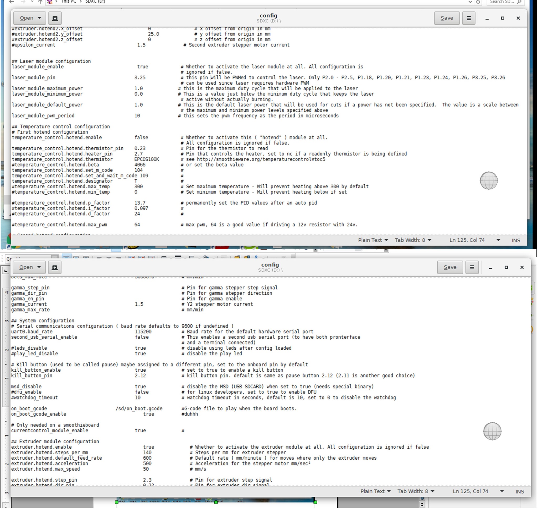

Ok, here’s what I get when shot:
6W Laser Diode//4.5 amp superX drive Laser driver//3.3v/5v logic level converter
NEMA 17’s
30a/12vdc p/s//2a/5vdc p/s (just wanted to unload USB drain,if any)
Win10 running LaserWeb3
Smoothieboard 4c/current config shown
Soldered to p3.25/connects to llc/logic level converter to LD driver/driver to LD
THE PROBLEM(s):
- The outline of the picture isn’t bad, but no details of the face. Laser spot size set in LW3 to .05 (and even thats a little large) Actual spot size about .03-04
- I don’t see how to configure pin 3.25 to open drain. Arthur Wolf asked if I had, and I told him no. Also said I was going to try the LLC first.
- Laserweb3 configuration: When I set (optional) commands to turn laser off and on to M3/M5, everything in raster conversion is inverted while firing laser (picture comes out negative on workpiece).
- LaserWeb3 command prompt:…does nothing at all. M3/M5/G0/G1,2,3/M999
