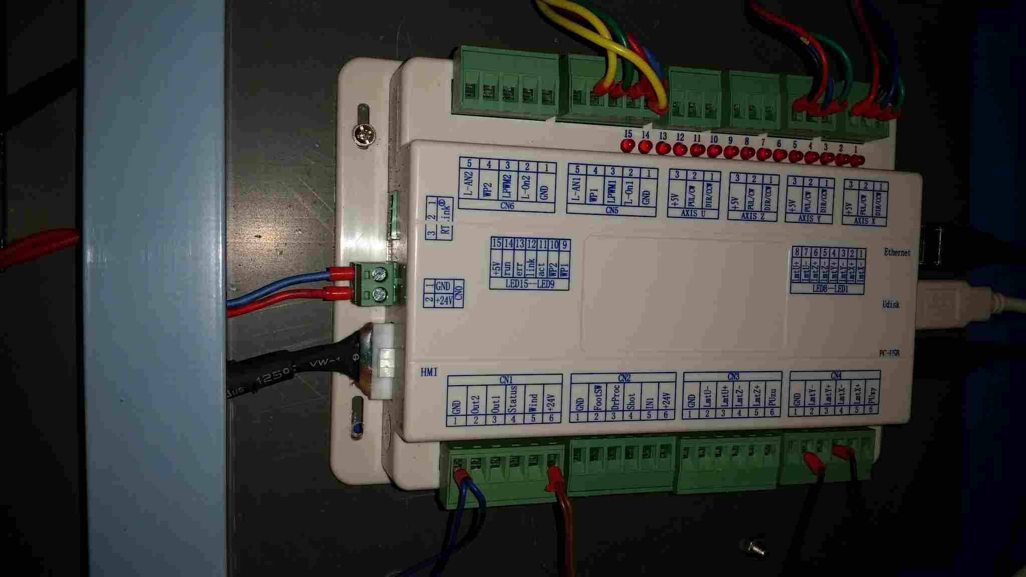

I have the 500 X 300 laser cutter and I am very happy,well made ,and smooth ,controller takes a bit of getting used to .can cut end etch in one go.tube not much more power than k40 as is only 80mm long vk40 700 ,measured 45 watts with my laser power meter,I use a plugin for coreldraw x7 .timed cut on k40 war 6.30 min and on the gh 350 was only 3 minutes .mine has manually table and red dot pointer.

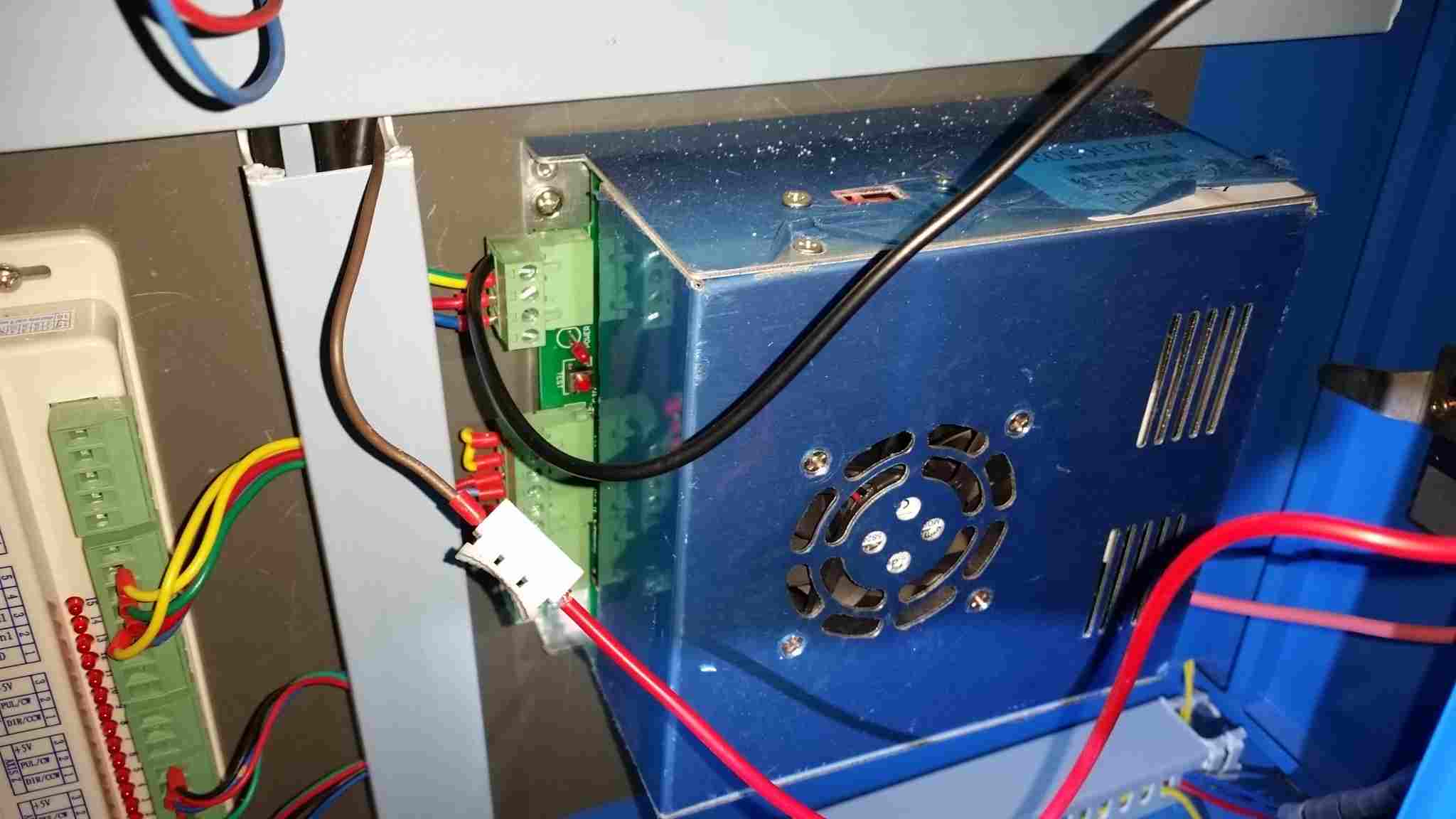

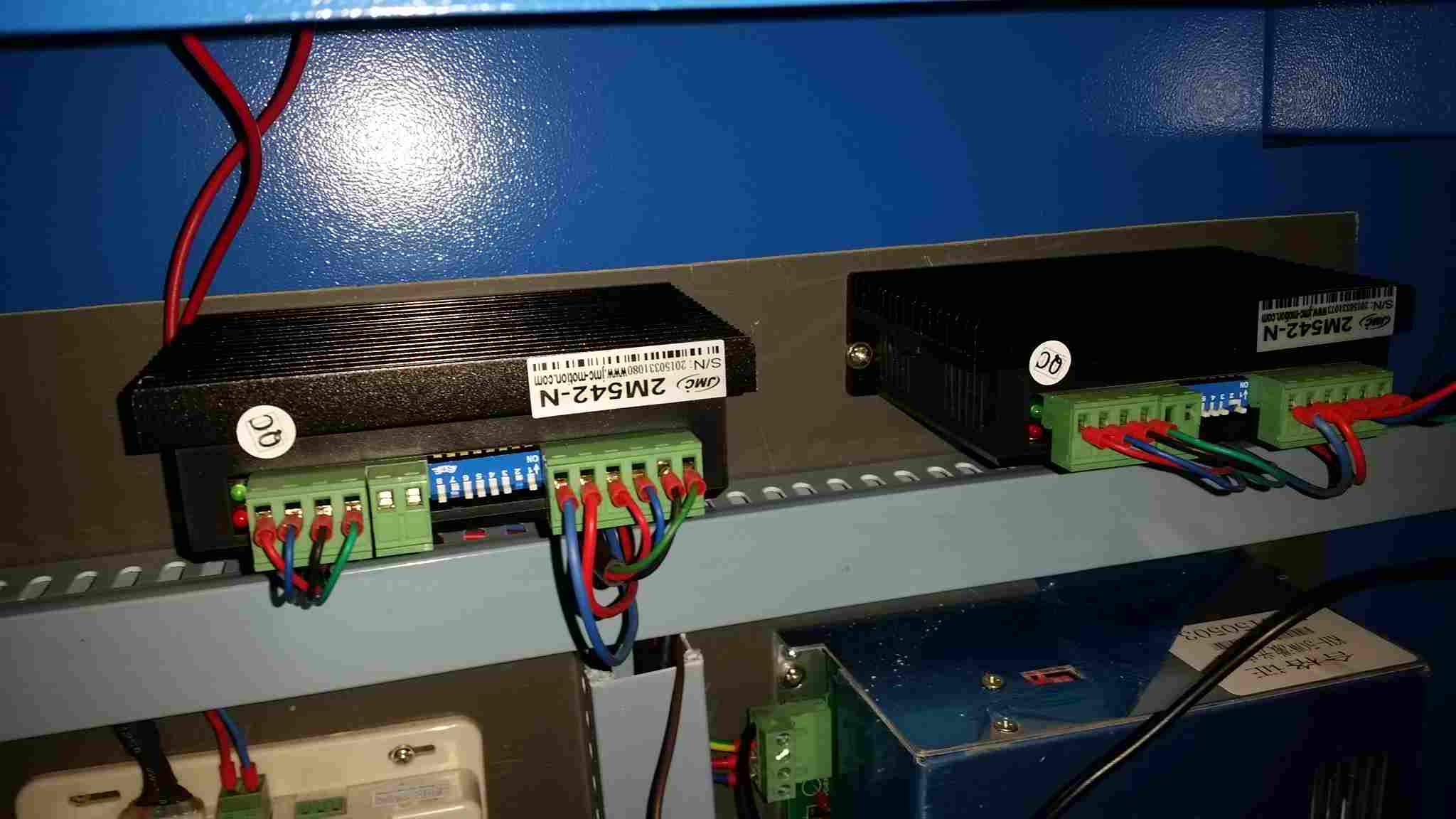

Off hand no,however the laser head is adjustable height wise and you can feed in extra large items from th front.the controller is great can cut and engrave in 1 file ,rdworks software is crappie, however most people just us the plugin for coreldraw or autocad.this machine is very well made ,with the mirror mounts and slide rails much better than the http://k40.it has air assist built in as well as water flow switch…The wiring of the machine is very good and the controller has spare inputs and out puts to control air soildniod etc.machine is so much smoother than thek40.The laser head zooms from one cut in the work peace to the next at a very good speed where the k40 takes forever . So far I have been able to cut 3mm plywood at 18mm/sec and 15ma.

I got mine second hand for 881 au,they brought it to cut cardboard inserts for mobile phones, however it left burned edges so they couldn’t use it.the machine sat around for a year unused so was worried about the tube being any good.have tested it with my power meter and is putting out 45 watts so all good so far.these machines have 800mm tubes so are not true 50 watts,more like 40 to 45 max.when this tube goes I will buy an extension and a longer 60 watt tube.might keep the 50wat power supply and try it on the bigger tube
