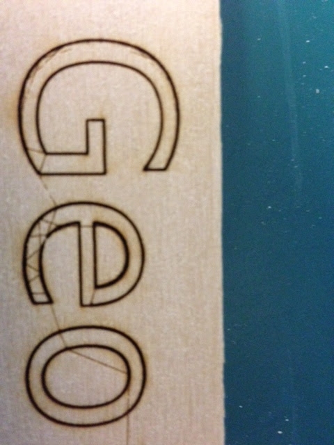

Ok I am getting close. I have the X and Y working correctly and the laser firing. I am getting faint lines between the letters when I etch. Its like the laser is not completely off. I am using an opticoupler to fire the laser it is driven from pin 2.5 inverted signal. The 5v and L are from the powersupply. I suspect that for some reason I am not getting a clean 5v so the laser is on at a very low level. Do I need a resistor across the 5v and L to put the signal high?

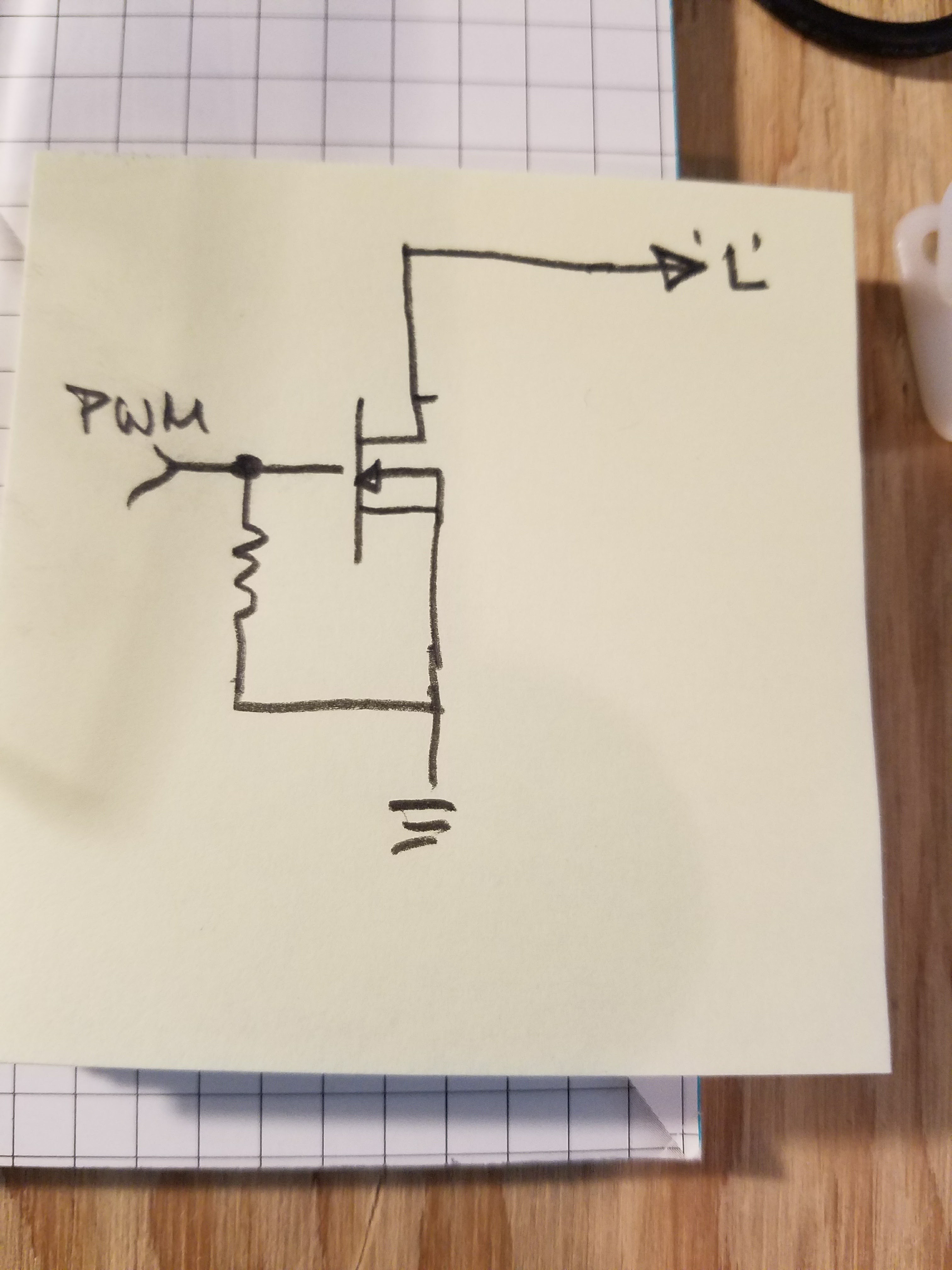

Simply connect the drain of a MosFet or the collector of a transistor both of which are driven by PWM.
That is what the “Simple Smoothie PWM Control” shows:

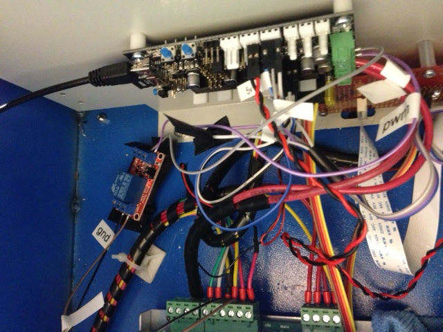

So this is probably the best photo that shows the optocoupler
there are 2 wires from the hotend connection on the right a purple and gray wire that go to the optocoupler on the left side of the pic. There are 2 wires on the other side of optocoupler they are brown and black. Those 2 are to the 3rd and 4th screw terminals on the middle powersupply connector.
@George_Fetters I am wandering in the dark here as I don’t know your exact config. so I am sorry if this is not helpful. Its hard for me to understand your configuration from the picture, a schematic of what you have done would help.

To drive the L pin you only need to find an open drain on the controller and connect it as my PWM control shows.
For ref here is a picture of what an open drain looks like. In my case I used P2.4.

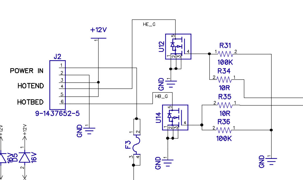

I am using this wiring diagram of the azteeg x5 mini http://files.panucatt.com/datasheets/x5mini_wiring_v1_1.pdf. In particular I am using the hot end connection + and - which equate to pin 2.5.

So if I understand this diagram correctly I just need to connect pin #4 on J2(which is the - of the hot end connector) to L.
@George_Fetters yes pin 4 looks right just connect it to L and make sure configuration is turning that fet on for pwm. Likely that means not inverted.

Looking at the picture at the top of the post we should challenge whether or not we are working on the right problem.
Although getting the PWM on “L” without a level shift-er etc is a good thing to do, if the PWM was not working I wouldn’t expect it to manifest like the picture above. If you are connected to L the only thing that input can do is to turn the laser on or off. It cannot partially turn the laser on.
Are there any other connections between the controller and the LPS?
Lets reset as to what we think the problem is:
- Are we trying to get rid of the thin lines that are inside the characters?
- Do we think these are caused by the laser being still on while its moving to another position to engrave? (I am assuming these lines are not in the image we are trying to engrave?).
- Do we think it is something else?
