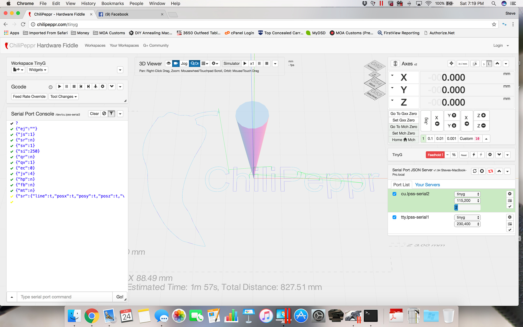

Are you sure cu.lpss-serial2 is the correct serial port? One way to tell what the correct port is, is to yank out the USB cable and refresh the list. Then plug in USB and see what’s new. On Win and Linux machines SPJS tries to look at the VID/PID to show you an icon that it’s TinyG to try to help.
I’m not sure which port I’m supposed to be using. I pulled the USB and refreshed, and nothing changed. Here is a screenshot of what my JSON server is reporting…

Thank you John. Nothing has changed tho. I tried to go into the tty.lpss-serial1 port and program the firmware for the card (which shouldn’t be needed, since it works fine on a PC) and it couldn’t find the card. Here are a few screenshots of chilipeppr and JSON.
And the JSON…
Keep in mind that your problem appears to be that your operating system can’t load the serial port at the USB level (maybe because of a driver). This problem is not ChiliPeppr or SPJS. If your OS doesn’t show your serial port, there’s nothing any app can do until your OS is showing the serial port.
