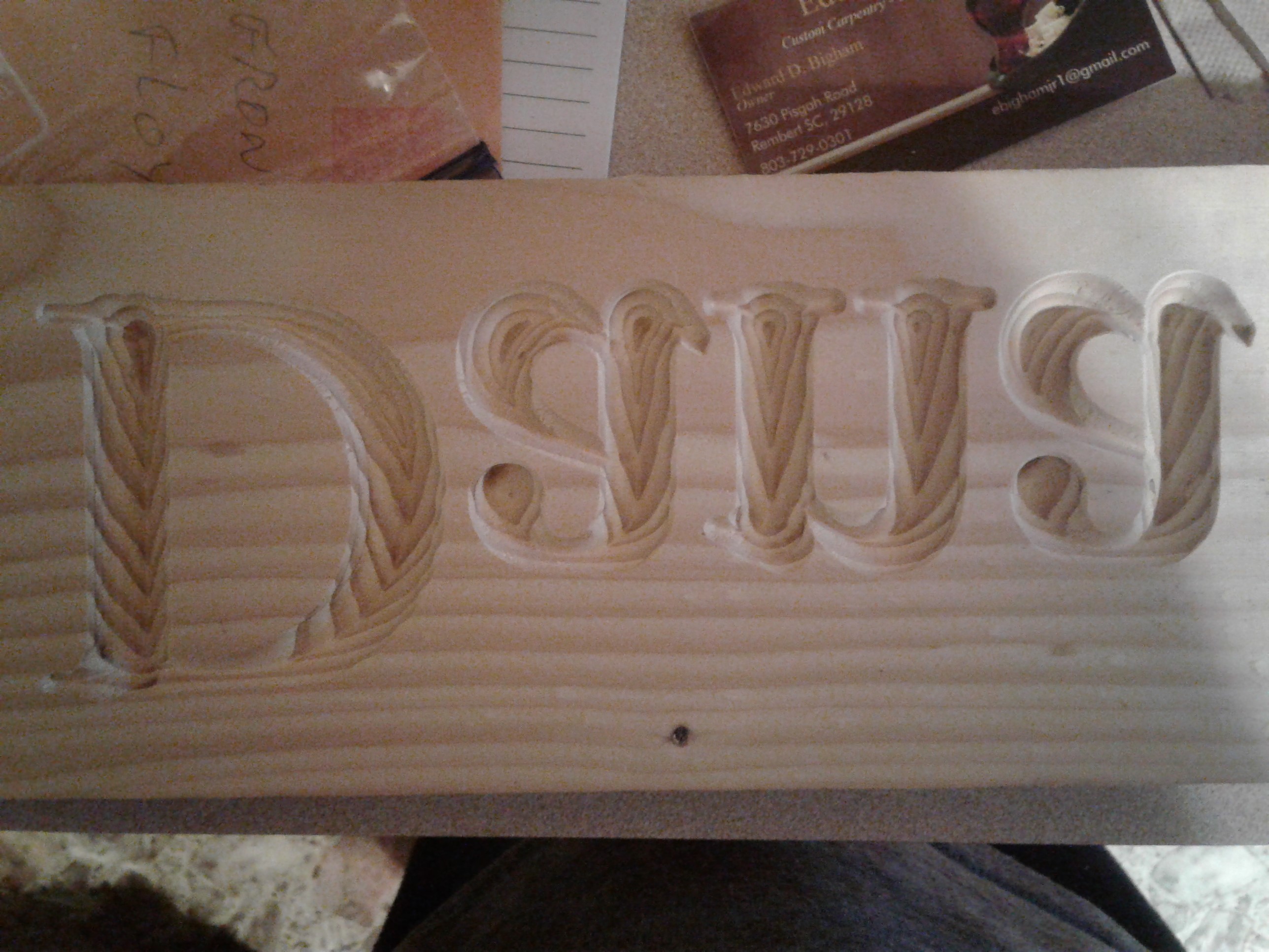

Ok I got it to work. Kind of. It still is a pain zeroing out everything. It is very buggy. and will lose zero. But as you see below one of my axis is set up backwards. It is supposed to read “Dana” Does anyone know an easy fix for this?
Sounds like the y axis is configured wrong on the TinyG. What settings did you configured it with? There’s a tinyg config floating around this group somewhere. But it may need modification depending on how you wired up your motors.
$2po=1
$3po=1
assuming you used motors 2 and 3 for the Y-axis.
@Colin_Kaminski yes I did. I will try this in the morning. Thank you again. Hopefully cncjs will zero out without any problems.
Getting closer! You might want to start with some simple gcode by hand. No cutting.
Home, then zero your WCS work. Then command “G1 X10”. It should move to the right.
Check Y axis code also. Then you’ll know if it wasn’t a setup option in Vcarve (it has options that will flip etc).
@Jeb_Campbell thank you. I will check that also.
That’s a good point Jeb, in Fusion I have to set the WCS (work coordinate system) to match my table. As convention I chose to use the near, top, left corner as home. I must make sure that the G-Code generator also does this.
