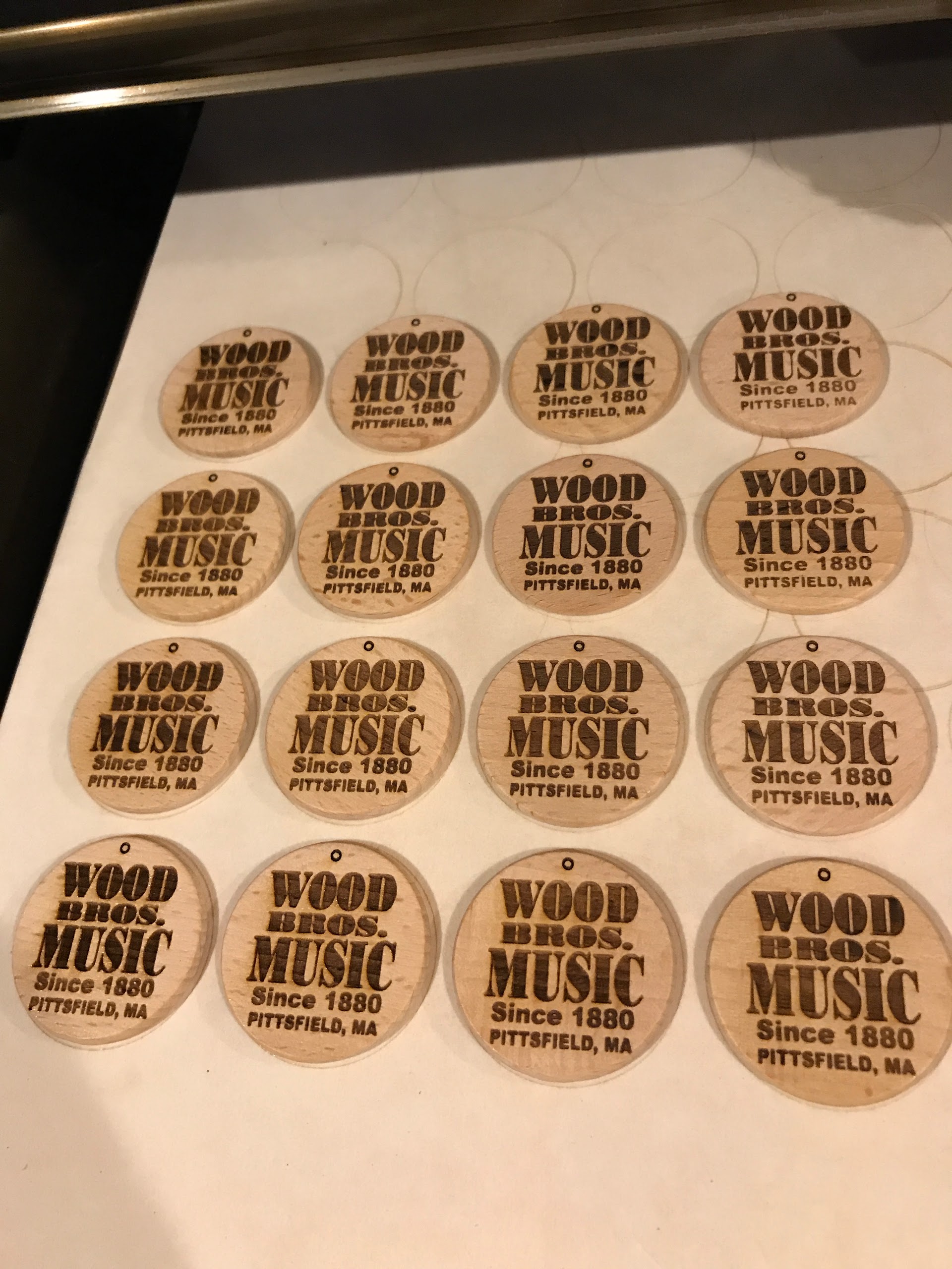

A run of custom keys chains for the music store where I work. My end stops haven’t worked since I got the machine, so I had to get creative in lining everything up run to run.
I decided to make an index alignment template by running a very low power cut on a masked piece of ply. Then lined the rounds up and engraved then that way.
Thank you all for the kind words! I ended up settling on a slower speed and lower power for the smaller text to keep the detail for the engrave.
