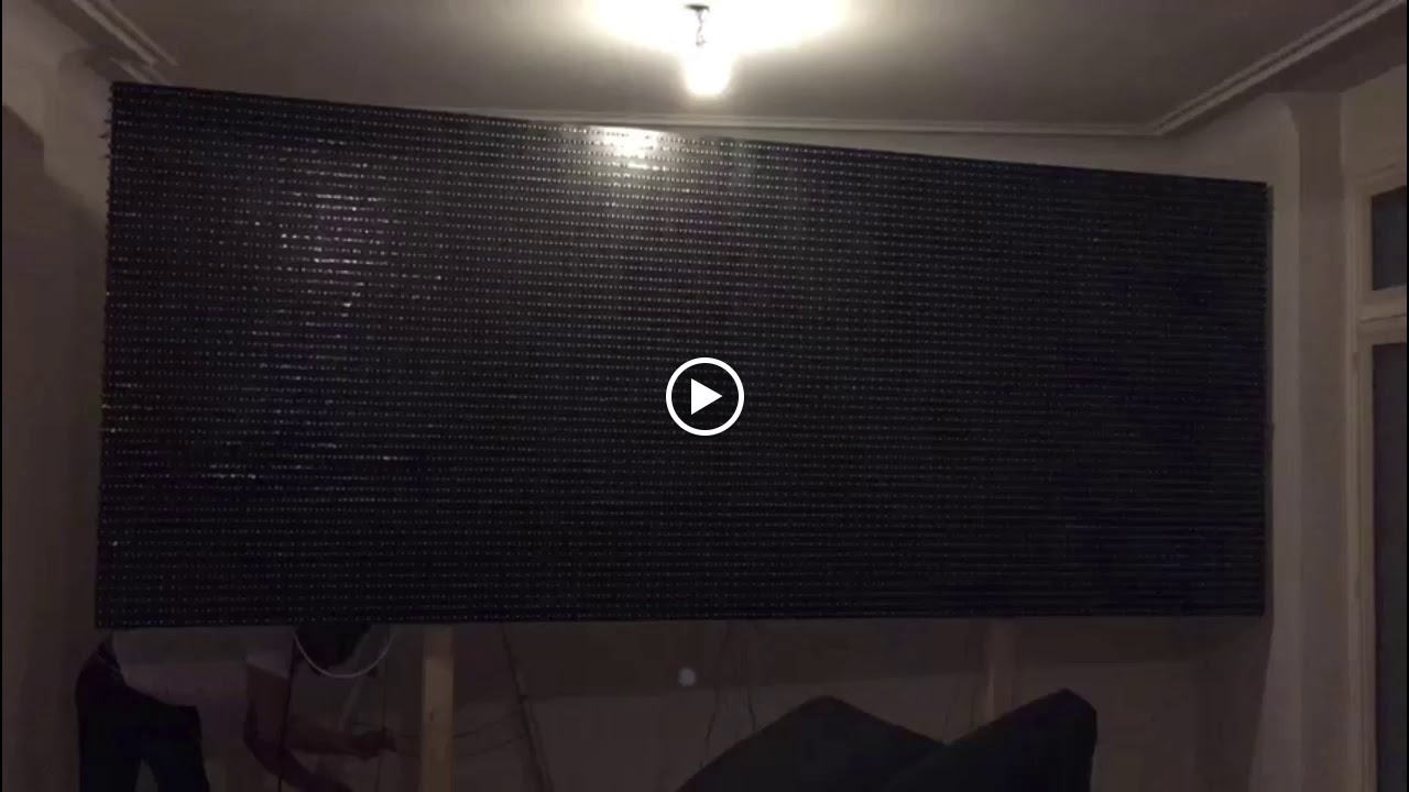

Ok it’s done !!! it’s up and running the word ‘UP’ not being figurative
Ok it’s done !!! it’s up and running the word ‘UP’ not being figurative !!! Thank you for all the advices.
123*48 leds 16 parallel output #esp32 !!!
Next stop. Plug my new board and a bit of tidy up
And of course a lot of programming !!!

@Yves_BAZIN Living room found back ah ah ah! Great work! Where does the video source come from?
Looks great! Are you using 30 pixel per meter strips?
@Matt_Richard yes 30led/meter
@Derrick_Giscloux the movie frozen

Haha, impressive. So, almost 6000 pixels, nice. How many amps is that? Still running on 5V? What pixels are you using, and distance between each pixel?
@Marc_MERLIN I have a 1200W power supply 240A normally I should run 360A but I never go more than 64 in maxbrigthness. I am using 30led/meter
That’s a bit insane :slight_smile: / I’m surprised that no one is making 28V neopixels
@Marc_MERLIN indeed that would be better :wink:
