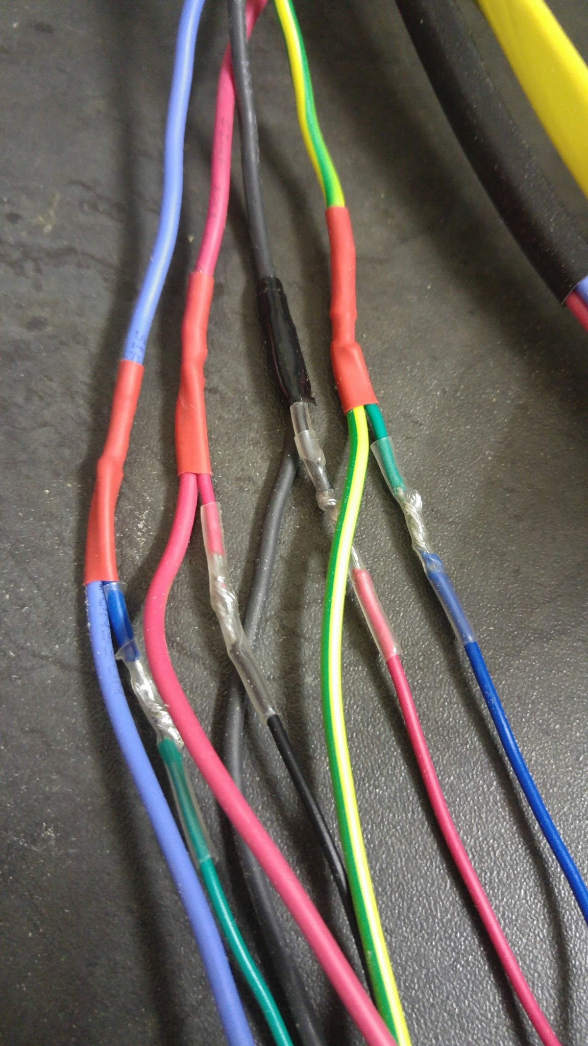

Ok it’s just about done. Just have to figure out the finer details of running it. Vs 3D printing the difference in running a Cnc machine is at a magnate of 10x as is the mistakes. Those 100mm X moves accidentally executed on Z. Let’s just say my E Stop is been pressed more on this machine in the last few days than on all my 3D printers together over the last 3 years. One rookie mistake see if you can see what it is from the picture attached. I’ve just measured the bed and cutting area is 800x750 which I think is sufficient for now, I did build it so the table can be removed to allow cuts below the machine. One of the reasons for building this machine was to cut holes in a table top that’s 2,5x1meter so the machine will be fixed to the table and moved a few times to make the cuts.

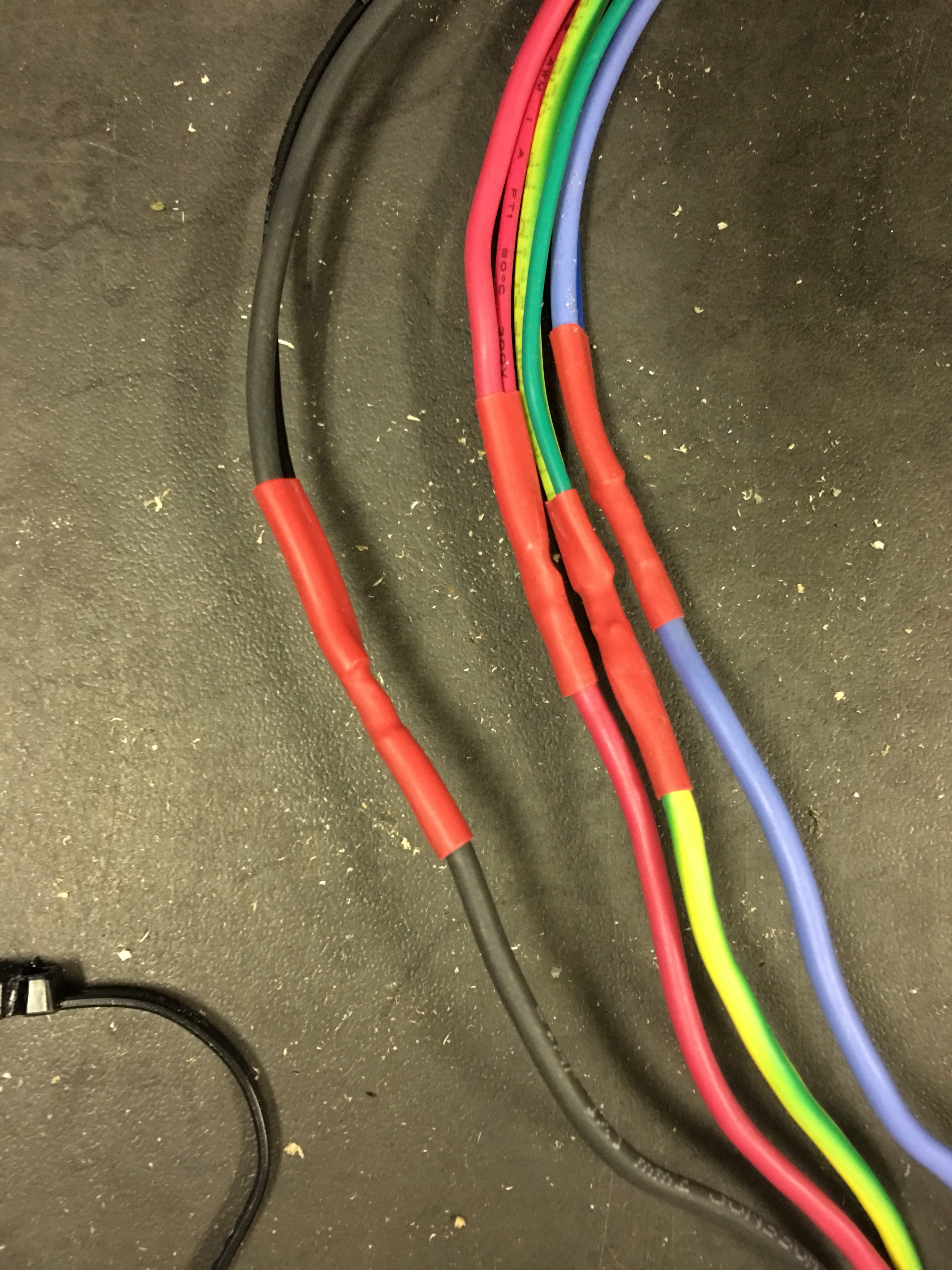

I wired the two opposing stepper motors on the Y axis the same not in reverse. Here’s the fix.
Ahha. Well, at least you knew how to fix it. :slight_smile:
