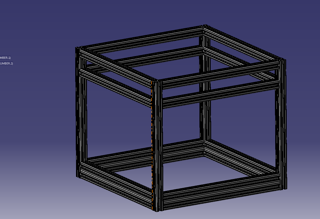

OK, I’ve put off ordering parts long enough and I need to get a new printer started. My only hesitation is that I want to go as large as possible but I’m not sure what the limits of this style of printer would be. Maybe i’m better off looking at a different design? Any suggestions?
Describe how big you want to go and we can better address which avenue might be best to proceed with.
Well I’m thinking maybe it’s a good idea to first build one just a bit larger then work on going larger. Maybe try for 18"x18" on X and Y at first. But I would eventually like to go as large possible and still fit through a standard doorway. Not sure what would be practical.
24x24x24 would be awesome. Right now i run 2 tweaked Robo R1 printers. One 14.5"x9"x8" So maybe replacing them with a normal sized herculien and then working on something larger would make the most sense. So many ways to go about this!
Yeah I would say much more than a few inch increase in HercuLien on the stock 10mm cross rods would be ill advised. For larger spans you will want cross beams with a greater cross section since your maximum deflection is a function of the span length squared. If you are going to scale up a lot, look at the quadrap G+ group. Something like the Black Pather QR should scale up further than HercuLien.
Just remember component quality and calibration time for larger printers is non-linear with smaller printers. Anybody can make an 200x200x200mm printer work well. It is an order of magnitude more difficult to scale up something to print at 0.1mm layer heights on printers that span 2ftx2ft. Errors become compounded over such distances.
Good advice. Would it make sense to step up to 12mm rails? Maybe building a normal Herculien is the best starting point and then i can figure out what to do different to go bigger.
@Nathan_Fisher I might go down that route first. Going big is not for the faint of heart
Also I have been splitting prints into smaller chunks and doing post print assembly recently. The cost of failure goes up as parts get massive… As does print time.

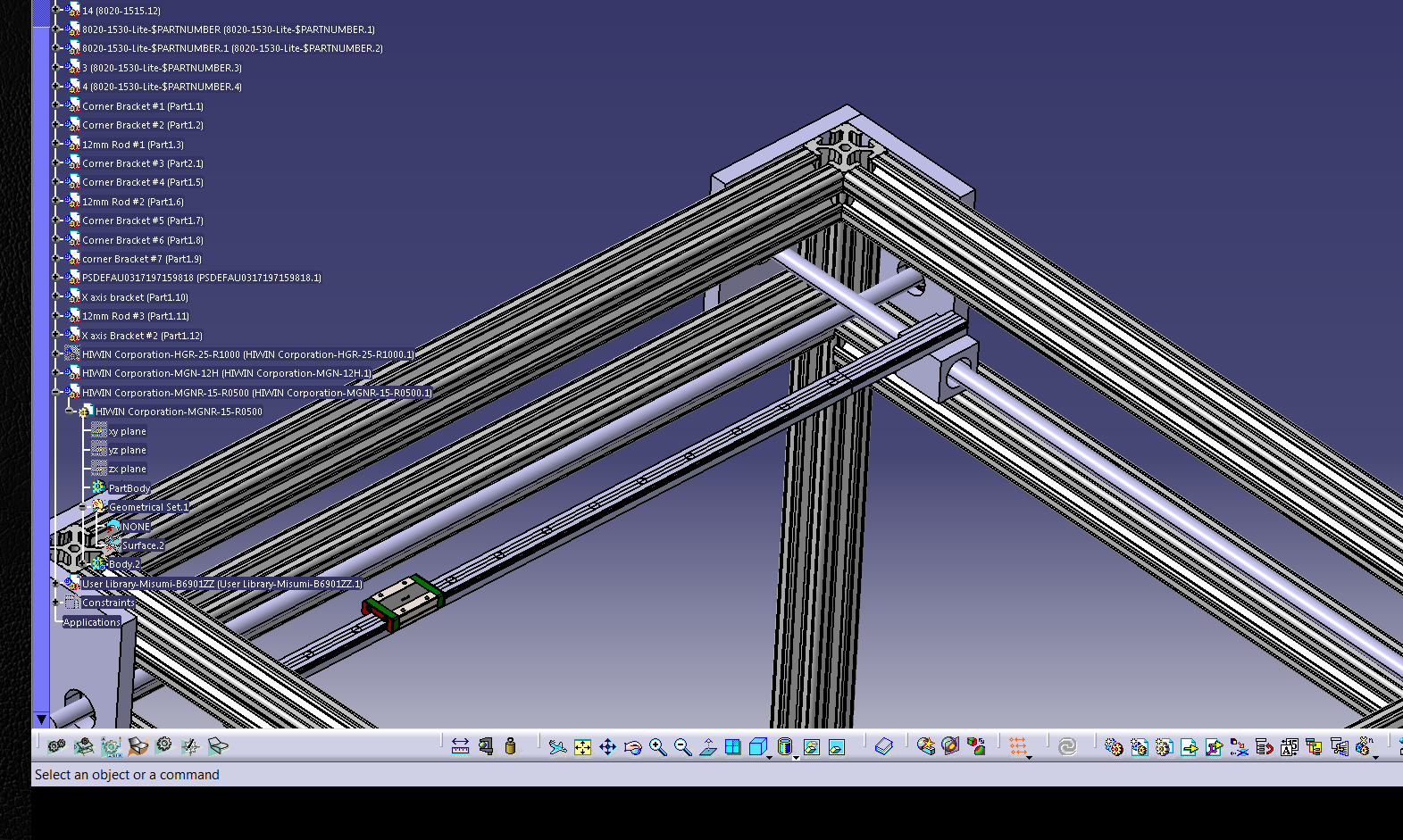

Well i think i’m going to try to build on your idea and see what i can do. I’ve modeled up the frame with 1.5"x1.5" and 3"x1.5" 80/20 extrusion. Outside dimensions of 27x27x24 but may go taller. Going to machine everything i can, use 12mm rods. Maybe linear rails if it makes sense. we’ll see. Should be interesting.
