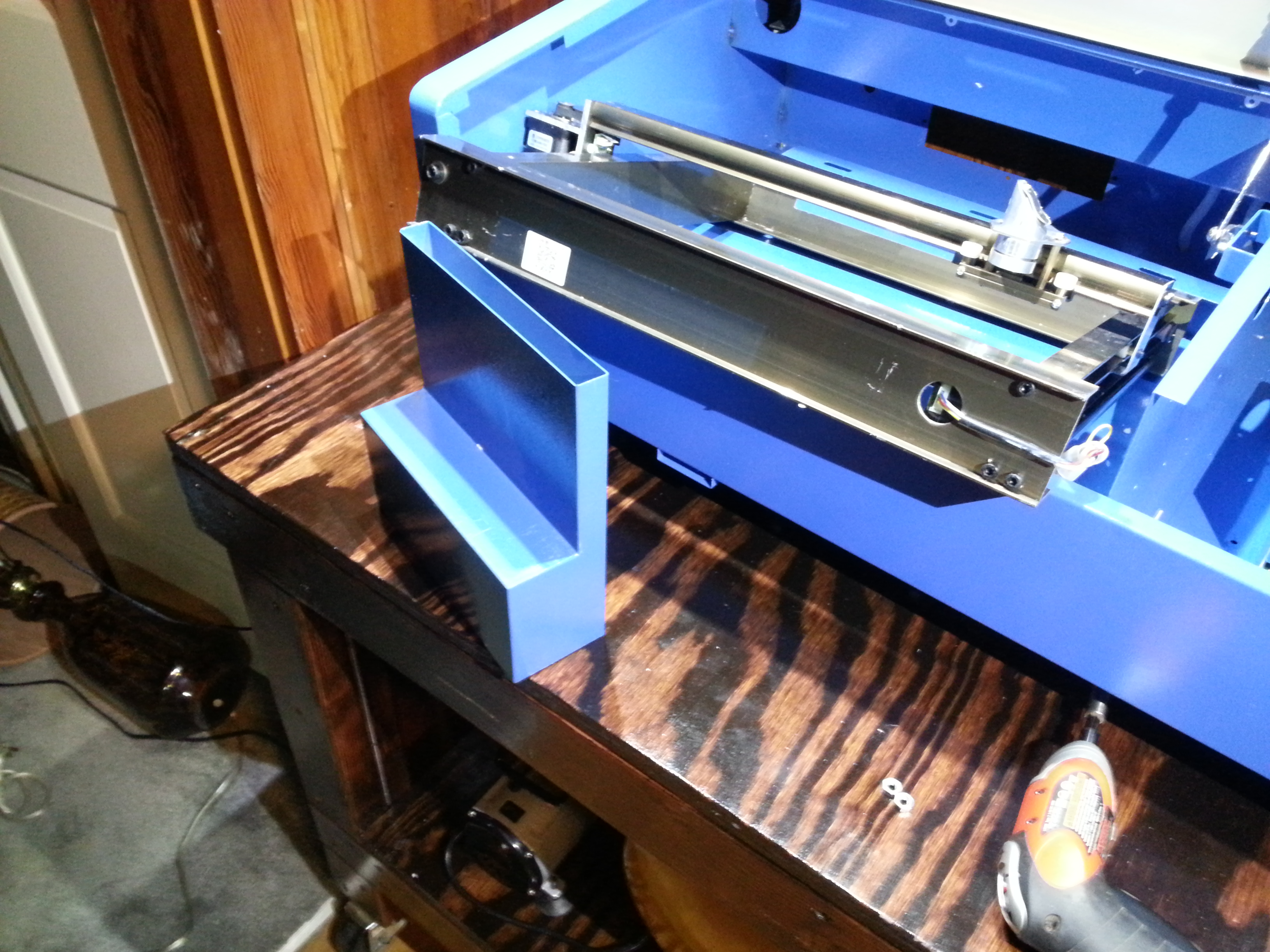

Ok just wanted to give a breakdown of what it took to removed the carriage frame for the first time from these so called 3rd gen blue box lasers.
The problem comes in that the inside vent chute is L shaped with a big bottom drop that sits behind the back mounting ledge for the frame. With the wide bottom drop you can’t push the frame back far enough for the front to clear the edge of the case. The vent is bolted in from the inside so it has to come out through the front. Unbolted, it is still impossible to remove vent as it can’t clear the mounting ledge. Tilting the front of the vent down gives more room but not enough, still like 3mm short. Above the vent chute on the inside there are 2 bolts that hold one of the mounts for the laser tube. These block the vent from being able to till down even more. So had to unmount the tube and removed the nuts. Also had to remove the left hand mirror on the frame so the right side would clear the locking arm hinge mount. After all this was finally able to wiggle the frame and vent out. Vent is staying out now or course. Lol, way more disassembly work then I wanted to start out with
The vent is worthless anyway. Ventilation is much improved when it is removed
I had the same issue, but I wasn’t willing to remove my tube. I cut the vent apart in-place with tin snips and removed it in pieces, took about 15mins. I designed and 3D printed a new one that mounts from the outside and only comes as far as the cut-out in the rear I-beam. Works great and can be installed/removed easily from the outside.

Hmm, I tried the tin snips approach, but after an hour of hacking at it, all I’ve managed to do is convert it into a jagged chunk of metal, still firmly wedged in there.
@Corey_Renner must have better tin snips than I do. Guess I’ll try again tomorrow.
@Tev_Kaber If you have a Dremel or other high-speed multi-tool with a cutoff wheel that will make short work of it.
I should have just done that, cut the vent shorter and left it in place. Instead I tried removing it entirely, I’m not sure I could reach inside with a Dremel to cut the larger part to get it out. Sigh, now I’m feeling like I should have left well enough alone…
File under “it seemed like a good idea at the time”… finally got the vent completely removed, now smoke removal is much worse, blows around the interior. I should have just cut the vent shorter and left it at that.
I think the next thing I’ll be designing to cut is a new vent.
