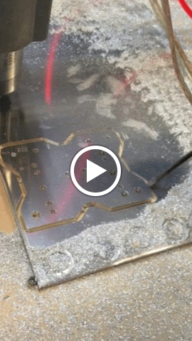

Ok, last video today I swear guys.
I, of course, put the thing straight to work.
Next front gantry at 250 .6 DoC…, wish me luck
Oh, and this does not include a finishing pass.
Very nice finish on the edges
Very nice. Is this 2000watt head?
Nah its a .8kW spindle.
Just did 220 x .6
Bout to run 250 x .7, break that boundry with a beautiful cut… its there.
20 hours of consecutive testing begins now.
