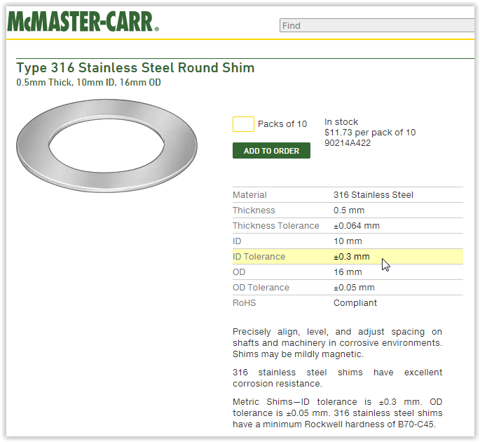

easiest way to tell is to measure the Shim ID and Rod OD. Now measuring small ID’s with a caliper is tricky to get right since caliper jaws have an offset, and the blade width can throw things off. But you should be able to get an idea which is the culprit anyway.
As close as I can tell they a within a couple of hundredths, but it looks like the shims are just under 10mm and the rods are very close to 10
I got the BOM listed shims from McMaster and had this same issue. I’m not sure which was actually off on size, but what I did to get around it was to use a light grinding bit in my dremel on the inside of the shims. Held the shims with vice grips, ran the dremel around the ID of the shim using light pressure a few times, and checked fit. Repeat until the shim fits.

I will have to find some other shims if these are an issue. Yeah, looking at the tolerances the -0.3mm is an issue. I will try to find some ones that have a proper asymmetric (offset) tolerance to fit over the shaft.

I forgot to follow up, but the ones I got from amazon had the same problem…to small on the ID even though they said -0 +.03 tolerance
